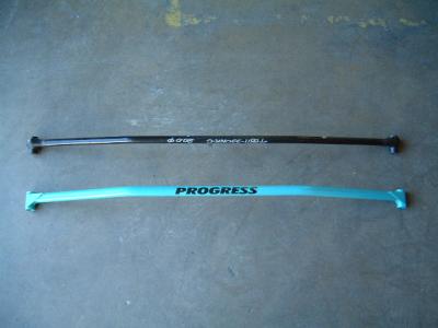

    Spacer Plates? Are you not using the Brackets that come with the new Prothane Polyurethane Bushings?
    Did your Progress Bar Part # 62.2150 come Silver or Red?

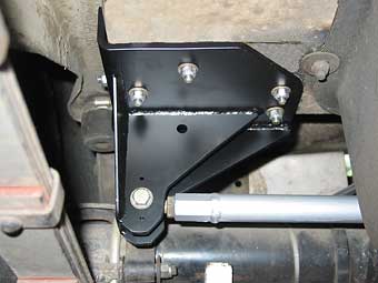

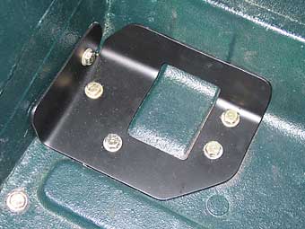

    So if a decided bar length was found - Don't think it would be too hard to fab up. Here is a sample Custom mount.
    [​IMG][​IMG]

  17. maestro8
    maestro8 Nouveau Member
    Feb 19, 2012
    471
    109
    nor cal
    How so? The Prius rear suspension uses a trailing-arm design; they're not located via leaf springs, as are the cars that typically use panhard bars.
    Edit: I'm reading that the design incorporates some arm deformation to achieve toe-out reduction under cornering. That being said, is the deformation of the trailing arms that significant in comparison? Has anyone measured it? To recommend a fix without sizing up the problem is questionable...

    Delivered!
