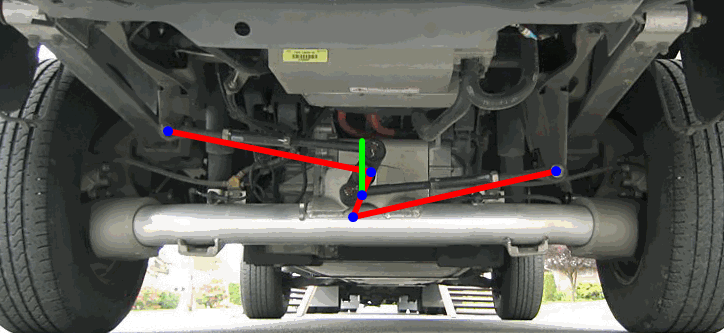

    Maestro has more of an understanding of how a cars suspension works than you do shovlhed. Even if he doesn't know how a pan hard bar works. no but seriously research it most race cars use this set up. And you will see the value in it when you realize why they are a good idea. if your neon uses a solid rear axle it will help you on the track.
    well actually most race cars use a watts link which is essentially identical to a pan hard bar.
    the only problem with shovlheds watts link theory is;
    how do you expect to fit this;
    Under a lowered Prius?
    Also there are lots of people racing there Prius's

    that quote was from maestro. read my post again.

    obviously, maestro knows how a panhard bar works. you however, seem to have no clue. the axle in your picture is completely different than a prius. once again, read my post. i never recommended a watts link, but it would do more than a panhard bar. the watts link does not have to be mounted just like your pic either, a good fabricator could fit one under a lowered prius. if you can't understand what i'm posting, you'd best not try modding any car. you ever been under a car?

    how is this axle different to that of a Prius other than size and leaf spings the principle is the same.

    oh man that is one sissy looking axle compared to the one above, I must say lol.
