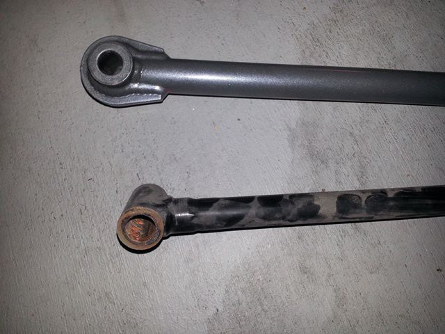

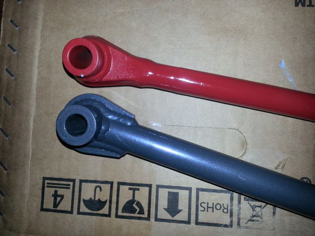

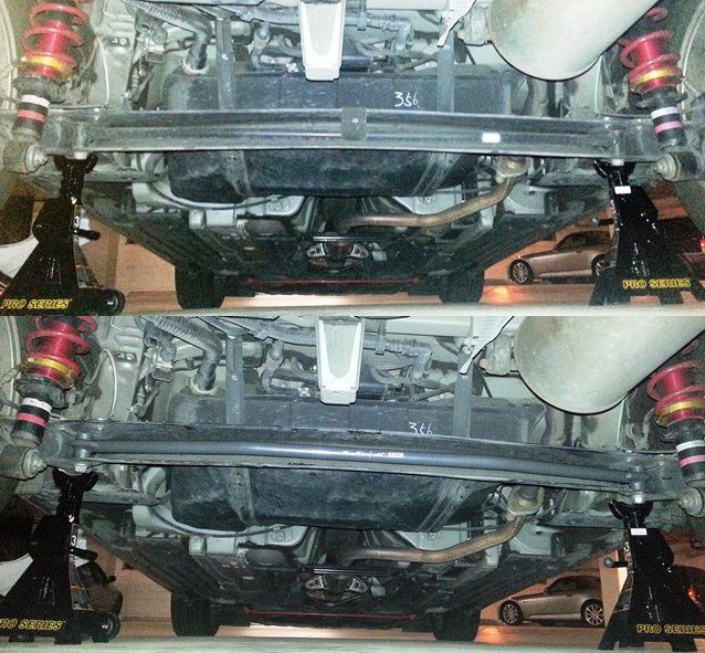

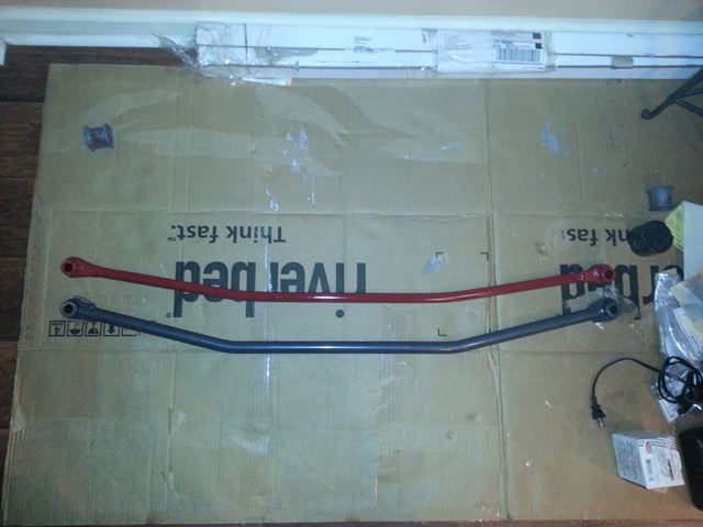

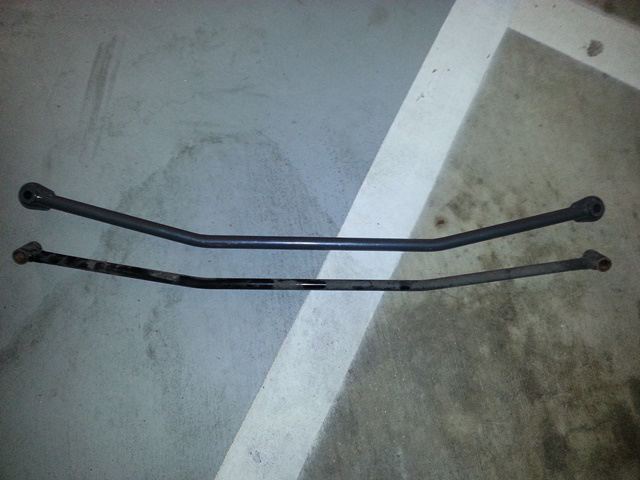

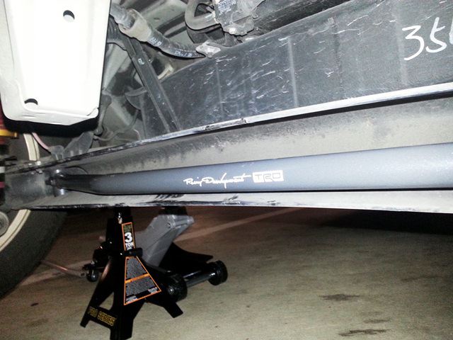

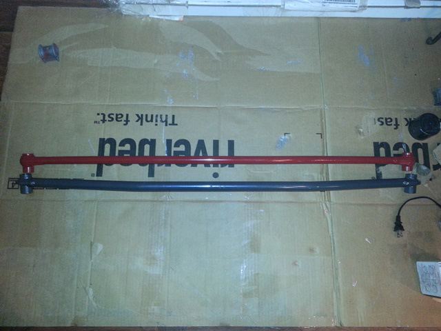

    The Corolla bar is a solid 20mm where the Touring is a lightweight hallow 20mm. Can't speak to the rigid difference between the two but I had purchased the Corolla bar, had prepped and painted it and was about to install it but then learned about the larger 24mm Progress bar. You can see the two compared below.
    Painted Corolla VS Progress Bar
    OEM Touring VS Progress
    Progress installed with a little sticker flair
    Before and After

    i would say that yes it would help. the oe prius bar is a joke. the corolla bar appears from justdidits pictures to be much better, and I'm sure you will notice some improvement

    after looking at the pictures in justdidit's post, you can see that the oe corolla rear sway bar is in fact heavier than the oe prius bar. I don't recall seeing that set of pictures before my post stating what I didn't know at that time. the corolla bar appears to have forged ends whereas the prius bar is just welded tubing. ultimately, you must look under a euro corolla and see if the bar looks to be heavier than a euro prius. either car might be different than their US counterparts.

    Did that: it appeared that the OEM Corolla bar I found is identical to my OEM Prius bar (same diameter, both hollow).
    So I decided to buy a Progress bar.
    Before and After
