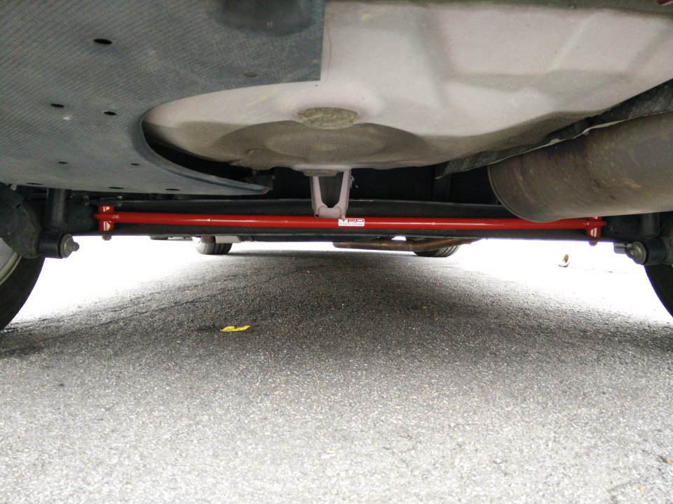

    Alright so the install took like 30 min. Super easy. Didn't even need a breaker bar.
    What do you do with the rubber piece that the sway sits on? Shave it down and fit it or is it not needed anymore?
  10. 69shovlhed
    69shovlhed Surly tree hugger
    May 13, 2012
    2,170
    752
    Delaware
    I threw mine away. never mind that, it looks way better then the boring gray progress bar. but tell us how you like it. tell us if you think it handles better.

    I took it for a quick run. First one hairpin turns the tires squeal a lot less and it feels like the back tires are more planted. I compared before and after. Definately worth the price. I didn't upgrade the rear bolts or nuts and torqued it to 130ftlbs. More than enough. The car lack enough power to get decent speed after a turn but it definately turns corners with more composure and stability. Will be installing the front sway from the matrix next and I should be done with my upgrades. Handles well enough for me.

    Looks really good! (y) I think the the two bars (Progress and TRD) are actually identical other than the paint and decal.
