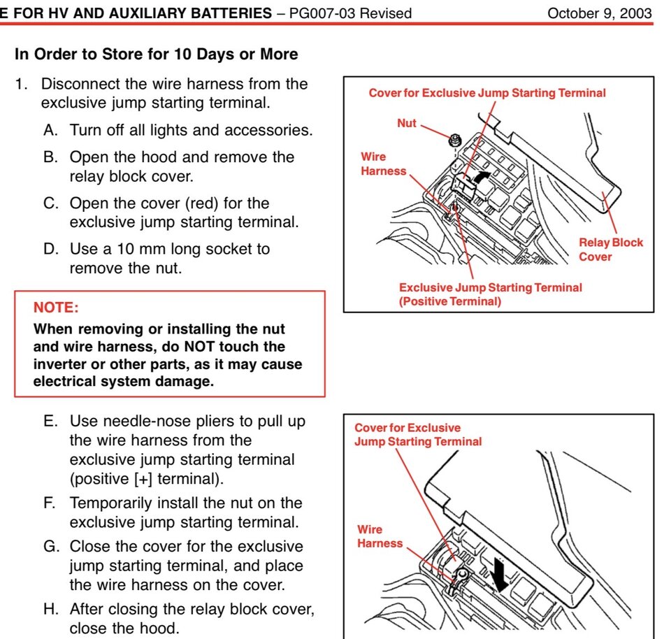

    Indeed! I just put a switch on the negative pole on my oldest g2, easily reachable from that little lower cover. Also posted this TSB showing another way to cut any drain or when stored in subzero temperatures using the jump start bolt.
