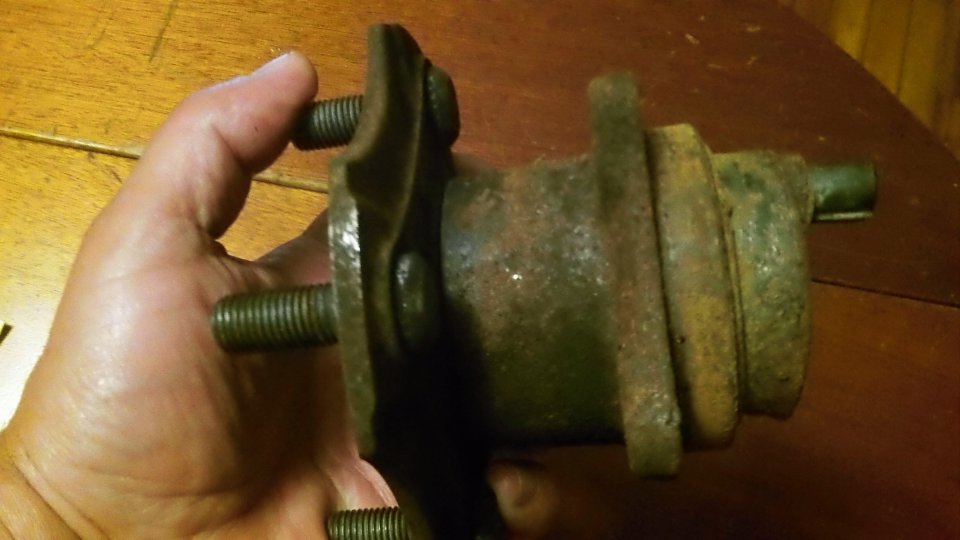

    Well, I got them apart. I soaked the backside of everything with penetrant a bunch of times. I heated the backing plate up around the hub with a torch for 10 minutes. Then I just pounded on the hub with a hammer, holding the whole assembly in place with a pair of vice grips via the backing plate. Eventually the hub looked like a mangled mess, but came loose.

    Bravo! may be mangled, but if you save 8 of them you can use them to play Bocce... 148_6181.JPG

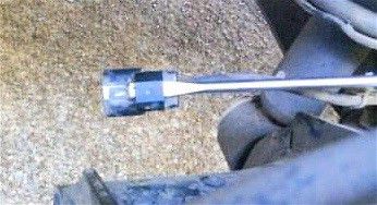

    A couple of undocumented procedures:
    • After cleaning out road-gunk, use a medium, flat inserted to free the socket lock.
    • Top bolts are 17 mm and bottom pair are 12 mm
