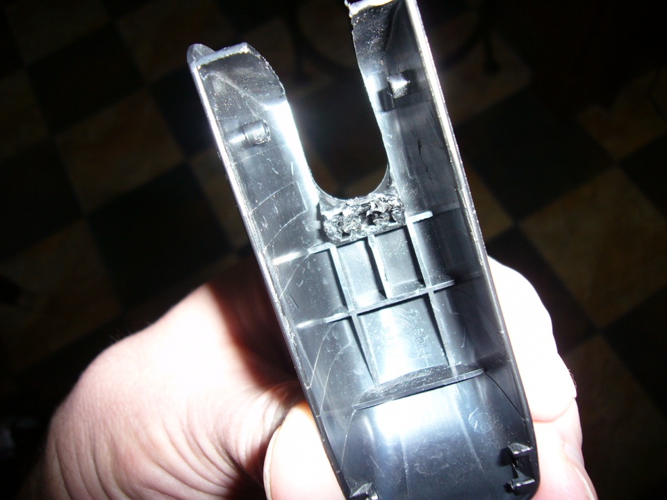

    There is a simple rear wiper mod for Gen 2 that permits lifting the rear wiper fully up when cleaning the rear window. Is there a comparable mod for Gen 3?

    The Gen 3 has a cover that can be raised to allow the rear wiper to be raised when cleaning the rear window. No mod just the way the car is made.

    It's been so long ago since I did it, that I forgot all about it almost! I remember that you take that cover off (just pop it off at the base of the wiper), then there is some little 'tab' sticking down on that cover you removed which is what prevents the wiper from raising when the cover is on. You just clip/file off that little piece, snap the cover back on, and then you can raise your wiper like it should have been made at the factory! Here's a pic of the underside of the cover on my rear wiper, and you can see where I filed that little piece down on the bottom side:

    Brunswick, GA
    ***just making sure you saw my response, in case you want to do the same simple little mod to your cover so you never have to take it off again to raise your wiper any time you feel like it...***

    I see - its the same as the gen 2. I made the mod to my gen and never had any issues whatsoever with flapping etc. I'm gonna do the same thing to my gen 3. It drives me buggy the way it is.
