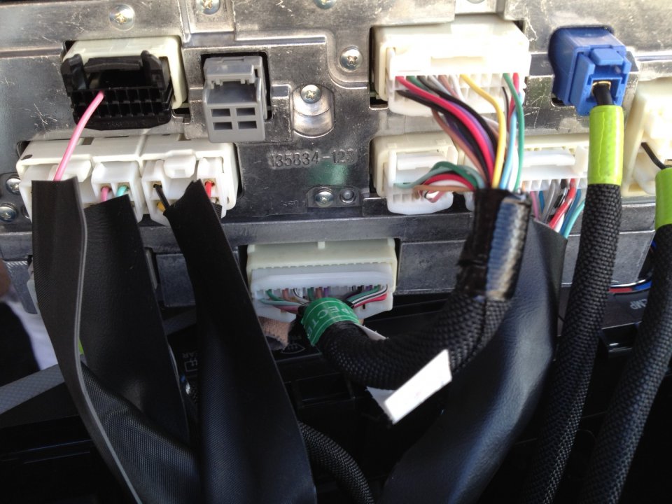

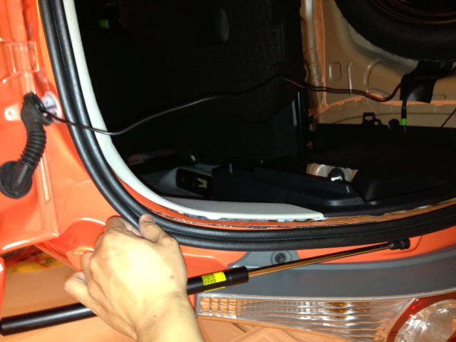

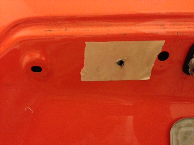

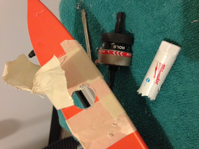

    Household drill will work, here is what I did with mine... You can buy the drill at Homedepot.

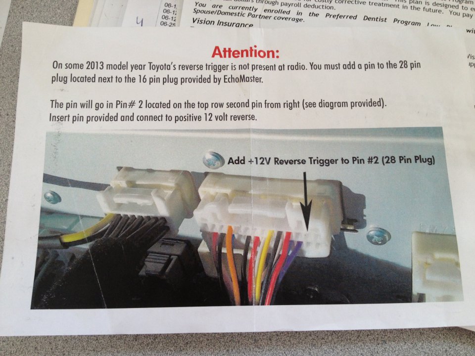

    Q Can anyone help with the final bit of this install?
    Background: I bought the American Security/Echomaster Kit that said it was for 2013 Prius C with Navigation:
    My installer got the backup camera in fine, the wiring done, but says he cannot see how to wire the back of the head unit for the trigger. There is a piece of paper that came with the instructions that says:
    "On some model 2013 model year Toyata's reverse trigger is not present at radio. You must add a pin to the 28 pin plug located next to the 16 pin plug provided by Echomaster; use pin #2 etc"
    My installer says the picture on the paper does not correspond to anything on the head unit (2013 Prius C Four with NAV) so does not know what to do. He seems to have the power connected OK. It is the trigger that he cannot see what to do.
    Does anyone have a picture of the connections for a Prius C Four Nav for this Echomaster kit, that shows exactly where to connect the trigger? I may have to get a rear view mirror hookup if I can't get this figured out and would rather not. Thanks for any advice/suggestions/pictures you can supply
    Norman

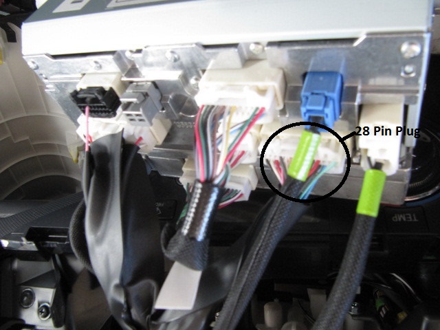

    Here's a pic of the back of an PC3/4 Nav radio
    As you can see the pin#2 on the 28 white pin plug is the reverse signal (green one), If you have it, a "t" tap is the option I think, if you don't have it, a pololu crimp pin (Pololu - JR Connector Pack, Female) is need it to connect the cable to insert on pin #2.

    Thanks so much. That makes sense. The problem is my installer insists (been back twice) there is no 28 pin white anywhere. It seems like the very late 2013 prius c nav I got may have a newer head unit or something. This is very perplexing. I haven't seen the view myself so have to go on what he is saying

    My mistake, In the photo I provide the 28 pin plug is below the blue plug and left of the antenna, I revised it, just in case. And It doesn't have any wire on Pin # 2, so you go with the Pololu option.
    Do us a favor, when complete connection, can you post photos of there the 2 cables is connected for the good of everyone.

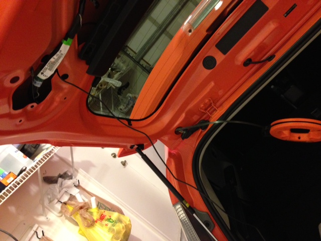

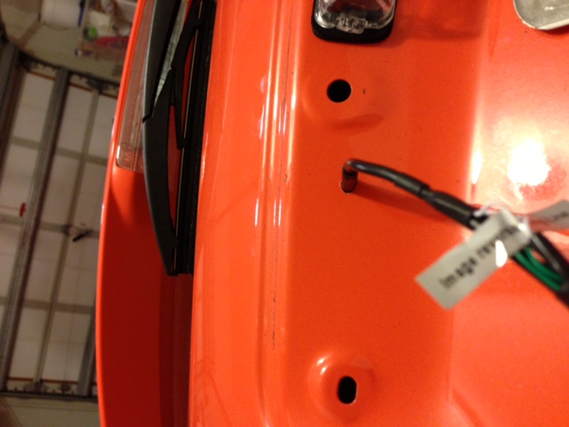

    yeah i took them out. they are pretty strong. heres what i installed.
  18. PRIUSrays
    PRIUSrays Junior Member
    Sep 19, 2013
    Nice job!! I think its crazy Toyota can charge like $600 for a camera setup but some of us have done it for under $20.Thanks to the good folks here at priuschat.I'm so glad I found these forums.
