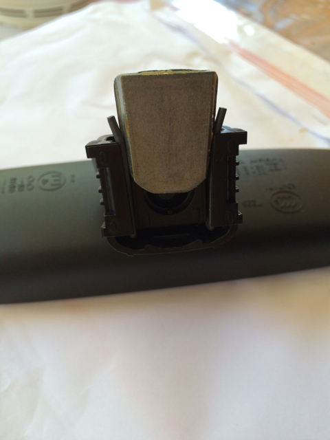

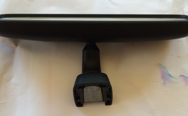

    Here's the assembled mirror:

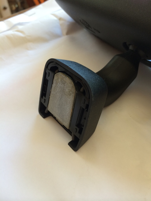

    Now I've removed the cowl from around the attachment point.
    [​IMG][​IMG]

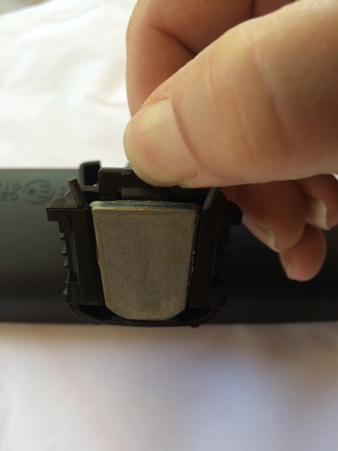

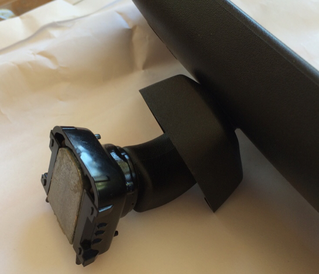

    Now I pressed on the tab, and the metal slug slides out. Obviously, it is very critical to orient this correctly when you glue it onto your windshield. I'm pretty scared of getting that part wrong.
    [​IMG][​IMG]
