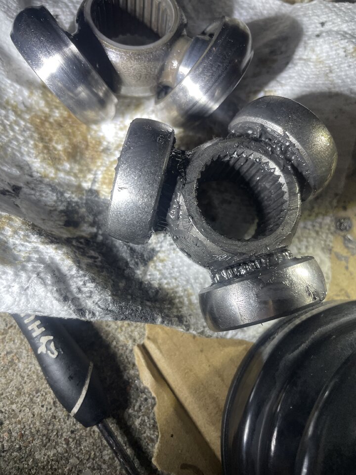

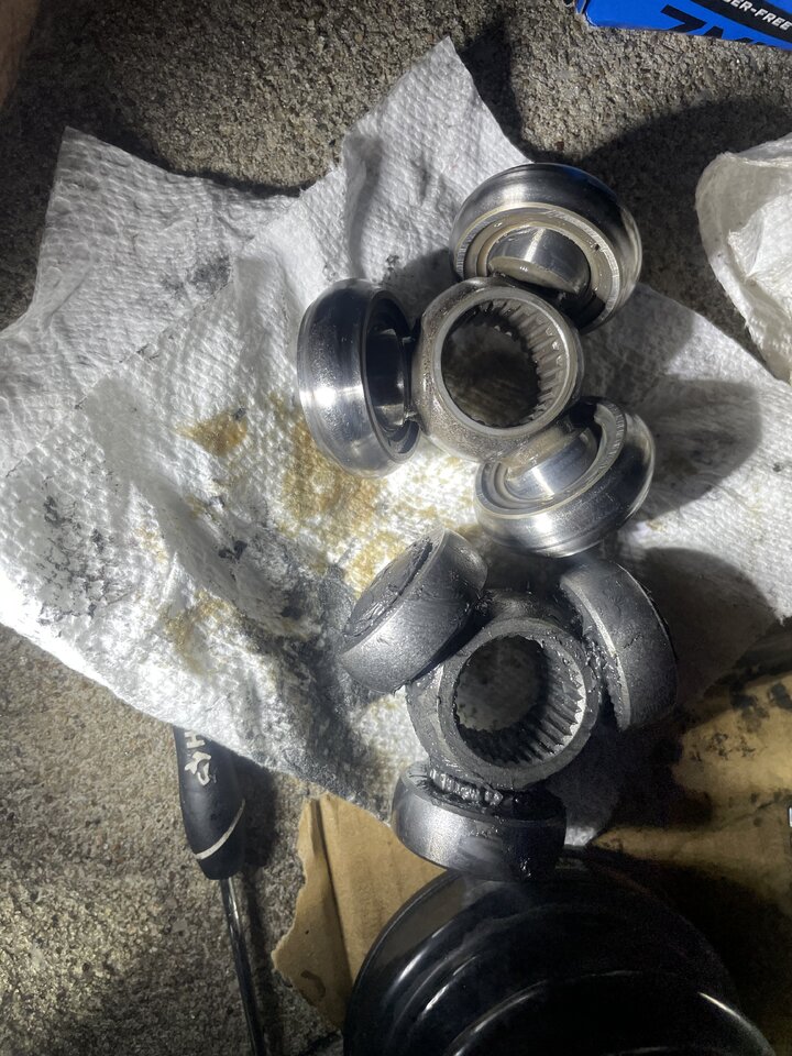

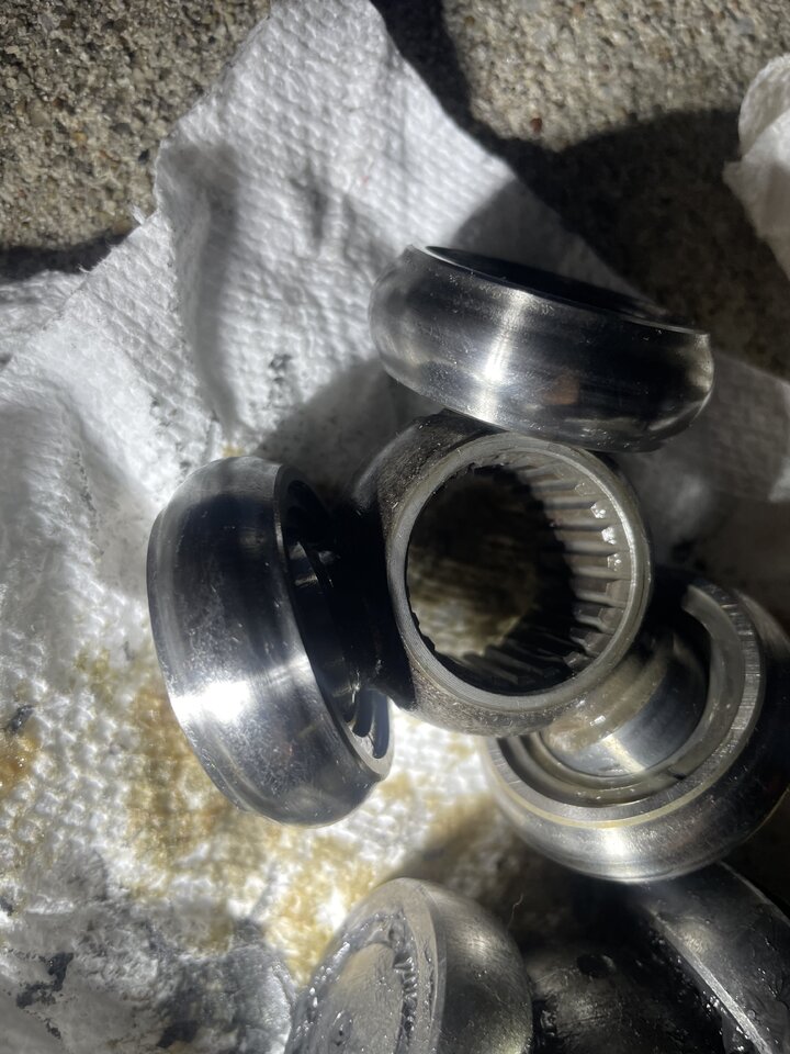

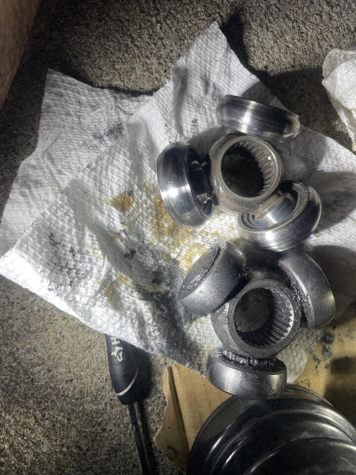

    I took apart my old and new axle. My main question is why the new axle doesn't have the same range of motion, should I just use the old axle/bearings? I've come this far...

    If you have the time and patience and special tools like boot clamp crimpers, rebuilding an original Toyota axle is thrifty, and leaves you with a better axle than an aftermarket replacement.
    Bob Wilson often reposts the three things you usually get to choose two of: good, fast, cheap.
    New Toyota axle: good, fast
    New aftermarket axle: fast, cheap
    Rebuild your own Toyota axle: good, cheap (cheap if you're equipped for it; less so if you have to buy the tools)

    The Car Care Nut has a very thorough video on rebuilding the original driveshaft, and he repeatedly advocates rebuilding, due to shortcomings of aftermarket replacements. IIRC it’s not a Prius driveshaft he’s rebuilding, but still worth a watch:
    full disclosure: never attempted this myself.
    (reported post to wrong forum, mod can fix)

    For future reference to anyone who may need this information later.
    You should use a lithium-based grease that is fortified with molybdenum for the outers. Im using Valvoline lithium base moly enhanced grease here.
    For the inners I'm going with Lucas Xtra strength.
