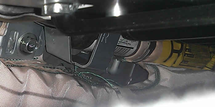

    I am taking my car in next Monday. Thanks for the picture.

    Finally got work done. Found this bolt on the rear carpet when I got home. Any idea where this bolt came from?
  4. Mendel Leisk
    60,290
    41,479
    Very common. Let them know.

    Do you think it's a critical part?
  6. ChapmanF
    27,624
    18,224
    Check out the procedure and look at the bolts in the photos.
    It is probably the old bolt from one of your inflators. Does it have signs of old Loctite on the threads? The bracket kit comes with new bolts. If that's one of the old ones, no problem, just discard it.
    If it looks brand new (never Loctited), then they might have reused one of your old ones by mistake, which they're not s'posed to do....
    -Chap
    m.wynn and Mendel Leisk like this.
  7. txl146
    txl146 Member
    Jul 4, 2011
    301
    NY
    Thanks for the reply. Went back to the dealer and they confirmed it was the old bolt.

    It does look a bit rounded, so I doubt it's a new bolt.
