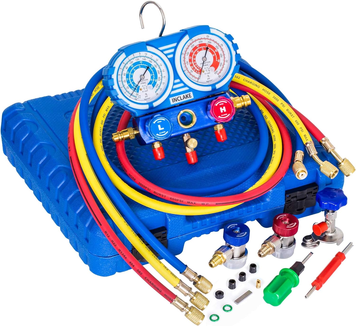

    Thank you for the feedback. I'm not sure how this would work on my gauge set. It's this one:
    EDIT: It appears I'm not allowed to post links, so I'll just attach a picture of the gauge set instead.[​IMG]
    It does have a push valve right above the fitting where you screw on the yellow charging hose, but it's my understanding that this valve is only for bleeding air out of the charging hose so you don't push a pocket of air into the system together with the refrigerant. When I was done charging the Enviro-Safe and tried to disconnect the charging hose from the can tap, a considerable amount of liquid refrigerant sprayed out, so not sure there's an automatic shut-off valve, or maybe I did something wrong.
    Any thoughts on the oil? I'm assuming some of the goo that sprayed out was compressor oil. As you can see from the first picture, the air filter box, coolant hoses, etc. are coated with an oily residue, and the stains you see on the plastic trim and windshield wipers is the same stuff. Should I add maybe 5-10 ml of POE oil?
    EDIT #2: To be clear, this mishap with the hose removal was days after I had charged the AC with refrigerant. It happened right after I had hooked up the gauges to check the pressures with the car running. I did not put in any refrigerant with the compressor on. The only oil I've added is the 45 ml I poured into the condenser inlet.
    The Enviro-Safe I used is the "Industrial" version without dye or any other additives. This stuff must be charged as a liquid. I believe that's because it's a blend of hydrocarbon gasses (propane and isobutane) with different volatility - so charging it as a vapour would give you the wrong mix if you don't use the entire can. I tried to charge it by weight holding the can upside down on a kitchen scale, but that proved almost impossible, so I gave that up and just winged it. The can had 226 grams of propane/isobutane which supposedly equals 598 grams of R134A. I disconnected the can when it was nearly empty and vented whatever was left in the hoses into the atmosphere.

    Yes, that procedure will work with your gauge set. Opening both valves on the manifold will "connect" all the hoses together, and allow the compressor to suck in most of the he refrigirantv

    I looked closer at your gauge set in the picture. It's a little different than what I would see in the USA. Yours doesn't appear to have a self-sealing valve on the end of the yellow hose. You would have to cap or plug the yellow hose or its port with a pressure rated (metal) fitting. If you removed the "extra" cap on center port of the manifold, would the free end of the yellow hose screw onto it?
    The idea is that you disconnect the high side service hose, then open both valves on the manifold while the A/C is running. Any pressure and refrigerant in the high side hose will equalize with the compressor low side. You would have around 30psi of gas left in the gauges. (So it can't "suck air in")

    I would have to check. I looked at the instructions that came with the manifold and it says to unscrew this cap (they refer to it as a "nut") and press the valve behind it with a screwdriver to bleed air out of the charging hose. I'll see if the other end of the yellow hose connector can be screwed onto it
    Is there another way to transfer most of the high pressure liquid back into the system without messing with the manifold? What if I let it sit for a while with both quick couplers connected to the car (and fully open), would the pressure gradually drop? I have the time to do this if that's an option.
