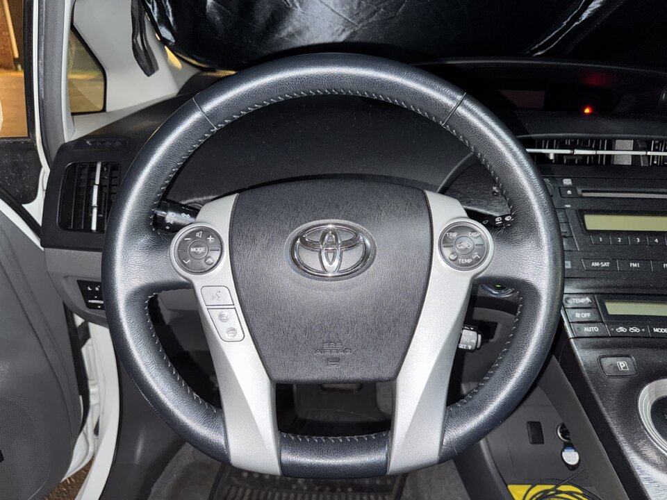

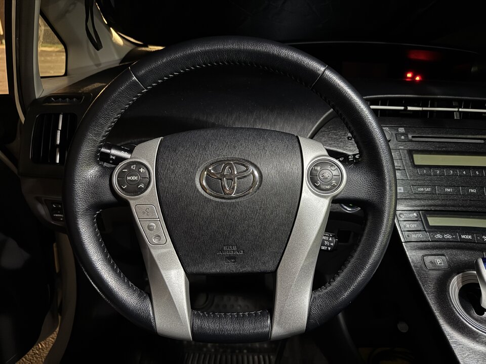

    Update: I ended up finding a SofTex steering wheel from the Prius V on eBay in the US and installed it yesterday - super happy with the results! If you can find a good used example from the Prius V, you can swap over the buttons, cruise control stalk, and airbag from your old wheel onto the donor, and everything fits and works perfect.
