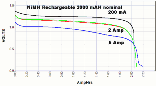

    I've had an 07 with about 90K miles for only 9 months.
    I have only done 1 reconditioning about a month ago and I'm still trying to make sense of the data. I notice no difference in the behavior of the car.
    My first discharge (down to 134V) took 11 hours, which seems long compared to others here.
    Second (101V) took 8.5 hours.
    Third and final (84V) took only 6.75 hours.
    Discharge time can be correlated to battery capacity?

    Total capacity (in amp hours) discharged is approximately = [current] x [time].
    The last time I ran my discharger, the discharge started at 1.3A for an hour then discharged the rest at 1 A. To make this simpler, let's assume the average discharged rate was 1 A. 1 A is approximately a 1/10 C discharge rate because the new capacity is 6.5 AH. Using the 1/10 C discharge curve below (labeled 200 mA), 99% of the capacity is used up when each cell reaches say, 1 V.
    On the Prius, a cell voltage of 1V means the pack voltage is 168 x 1V = 168V. So the estimated pack capacity can be calculated as:
    [average discharge current] x [time it takes in hours to discharge from the maximum voltage to 168V]
    If it took 6 hours to discharge my pack using a 1 A average current then my capacity would then be:
    (1,000 mA) x (6 hours) = 6,000 mA
    For the calculus fanatics ;), a more accurate way to determine pack capacity is with an integral.
    The math would be an integration from t1 (time where pack is max voltage) to t2 (time where pack is 168V) of:
    I x Δt
    Where I is current. The name for this integration is "coulomb counting". It's what the Prius computer uses to compute state-of-charge.

    Thank you for the information, mjoo!
    So, capacity of the Prius battery is directly proportional to discharge current and discharge time. I can understand why the comment was made about increased.
