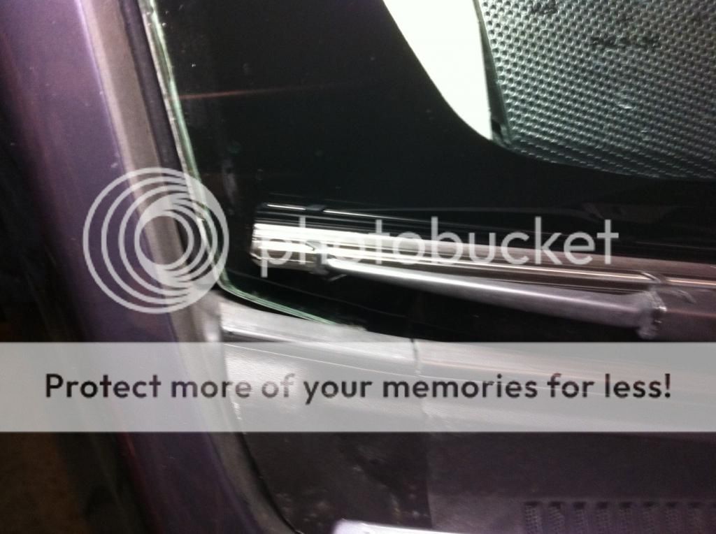

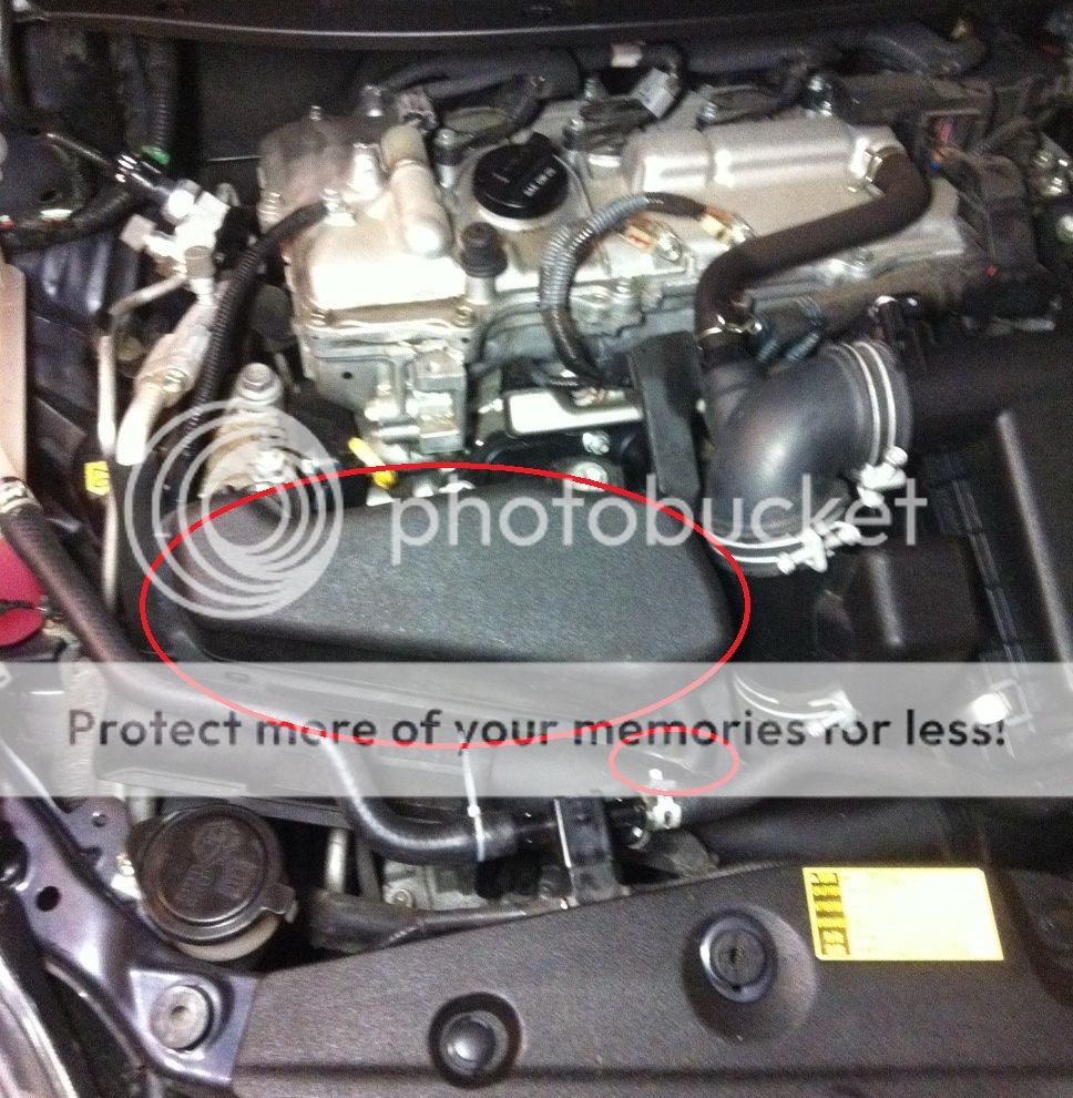

    I've finally had more time to look the car over with more scrutiny. The passenger-side quarter panel was smacked, and some frame repair was done, along with some 12v electrical.
    The only problem I have noticed so far is what sounds like wind noise coming from the lower passenger-side windshield. When I place my hand around the window, I don't feel any breeze, and no water infiltrates the cabin. I did notice there is a plastic insert on the inside of the driver-side fender that is missing from the passenger side. I'm wondering if this could cause the noise?

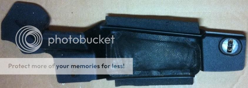

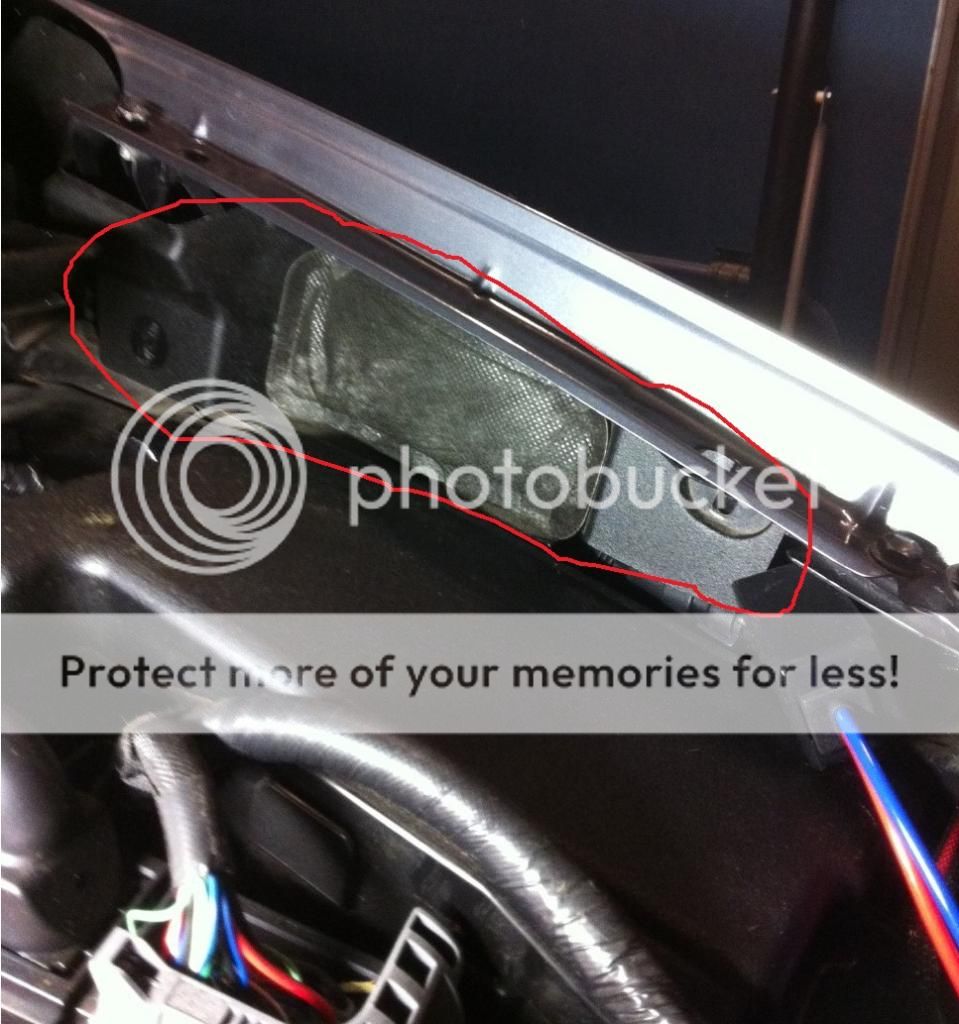

    Any idea what this part is for?
    Its missing from the passenger side, and you can see the frame repair.
    Here is the part alone
    I also found cracks in the air intake before the filter. Is it important for this to be airtight? In most cars the intake is just a tube that directs air into the filter, but the Prius one looks special, as if something else is going on. Should I replace it?
    There is a tiny gap between the plastic shroud and the corner of the windshield that isn't supposed to be there. The windshield is tightly sealed with whatever adhesive is used when it's installed, so I sort of doubt the noise is coming from that extremely small gap, although I suppose it is possible.
    I inspected the underside of the vehicle, and all plastic appears to be intact. Still haven't located the oil filter though.
