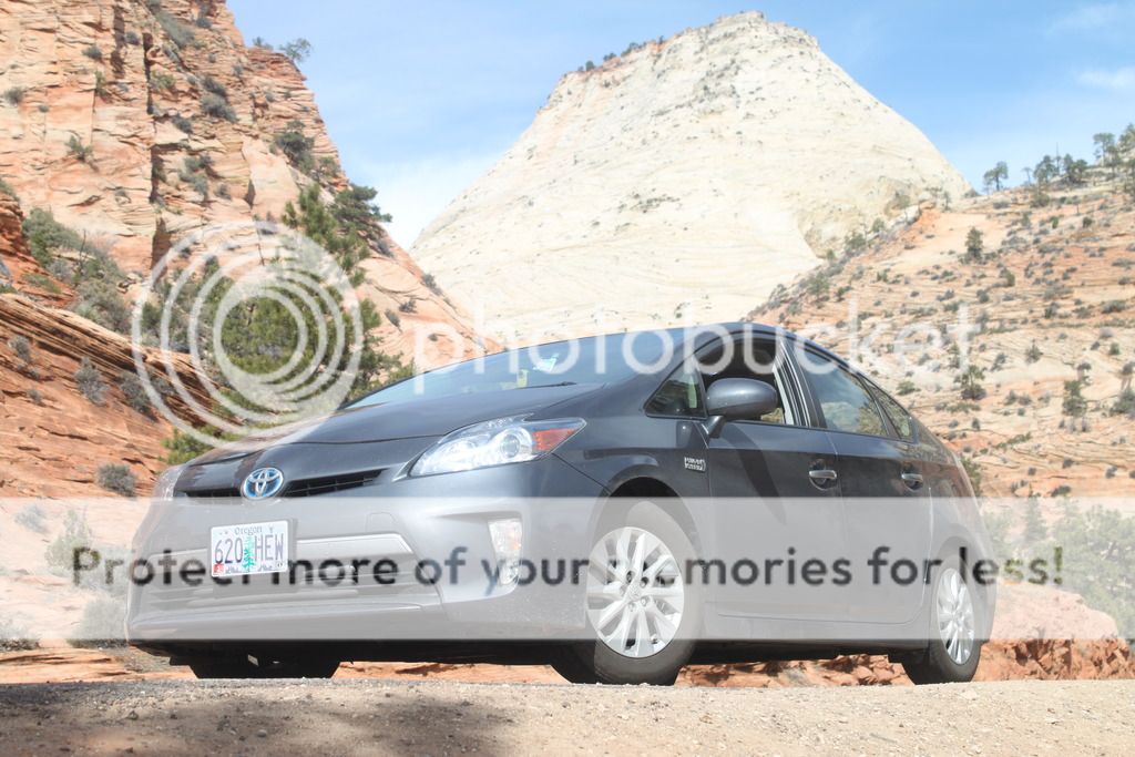

    Well, I've owned my PiP for a year now, and learned a ton in the process.
    The car has taken us on some fun road trips to Bryce Canyon, Zion National Park, Grand Canyon, Vegas, Creator Lake, and many weekend excursions. I like it better than my excellent Acura TSX because efficiency is more interesting to me than performance when using a vehicle as transportation.
    I've added a hitch, bought a 4-bike carrier, and have a 4 x 8 Harbor Freight trailer sitting in the garage waiting to be built.
    I had been wondering why there was a faint wind noise coming from the windshield area and above average condensation. Turns out whoever replaced the windshield forgot to use the activator on the top seal, so the entire top edge was merely press fit to the gasket. I could push the glass out and fit my arm through it.
    The glass is reset properly now, and I'm looking forward to another year of adventure.
