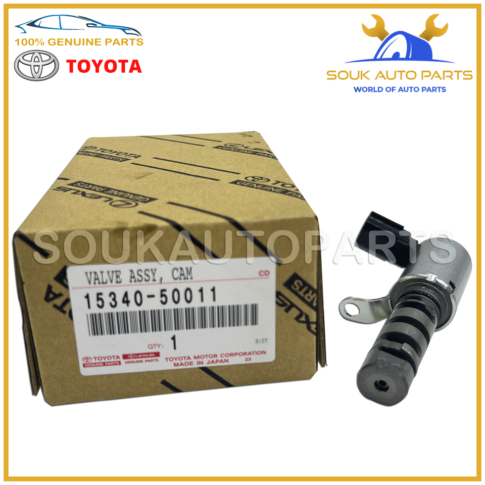

    15370-25020 is the item in question, they're like only like 80 bucks. All it does is press a plunger on the cam which opens the secondary vvti oil circuits. I have no doubt in my mind it could be built to open faster but it's likely the OEM one is already measured in milliseconds. My other vehicle has the older style solenoids and that one is also measured in ms.

    I don't disagree with any of that, but I was trying to point out that that the M20A doesn't use that type of solenoid to adjust intake valve timing, only exhaust valve timing. Intake valve timing is adjusted by the $1k part. And since any real performance gain would have to come from adjusting the intake timing...

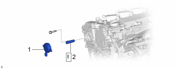

    btw, my understanding the part in question is part no. 2 on the illustration. or is it part no. 1? or both?
    part 1. CAM TIMING OIL CONTROL SOLENOID ASSEMBLY (15370)
    part 2. CAMSHAFT TIMING VALVE ASSEMBLY (135A0B)

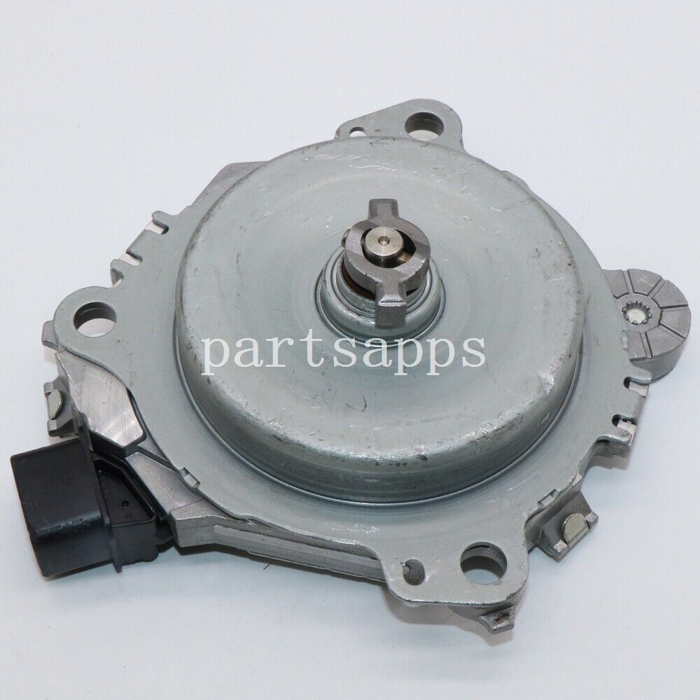

    This is what the gen5 uses on the intake. Inside that metal shell is an electric motor that spins at the same speed as the camshaft. It alters the valve timing by very slightly speeding up or slowing down and then rematching the cam speed. This system is called VVT-iE.

    Little electronic drive unit for the motor built right into it, too. And that picture doesn't show the two-stage cycloid reduction gearing they have living inside the intake sprocket ... answering the question how this eety beety motor works up the torque to move the camshaft. :)

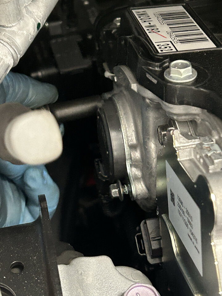

    Today we lowered a 2024 Toyota Prius on RSR coilovers. We were Blessed from him taking the trip from San Francisco to our Shop in SoCal for the 3 hour install.
    I casually talked about this thread on Prius Chat and invited him to test out the solenoid around the block. After a very long time testing the car (thought he took off) he came back with a big smile on his face!
    He then said ‘My wife will kill me’ and reluctantly declined the offer to purchase.
    Took about 5 minutes to remove and we sent him on his way.
    If anyone happens to be in SoCal by Knott’s Berry Farm you are more then welcome to stop by to Test out the Quantum for free.

    What a nice picture showing the Quantum solenoid installed on the exhaust, and the car's original 13090-25010 motor assembly, cam timing still on the intake. @Hammersmith nailed it.
    So is the story now that it doesn't matter whether you change a fancy solenoid for the intake timing (like all the previous gens) or change it for the exhaust timing and leave the intake unchanged, it gives you the same big smile magic?
