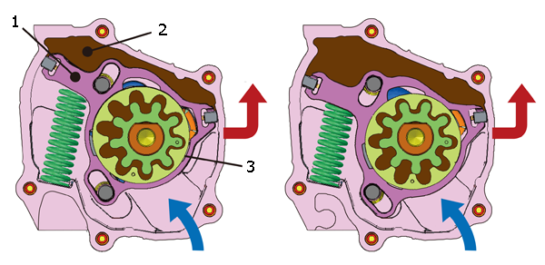

    This showing chain tension and referencing oil pump would lend me to believe the oil pump is chain driven. Referencing a 2023 XLE from ProDemand.

    It's both mechanical and variable. It's driven by engine power, but it has some way to vary pressure. The oil pump on the gen3/4 Prius engine used a fairly simple variable oil pump. The oil pump on the newer Dynamic Force engines is more complex and has much finer control over the oil pressure.
    Here's a link to an article that talks about both. Type 1 was on the gen3/4, and Type 2 is on the gen5.
    Variable discharge oil pump
