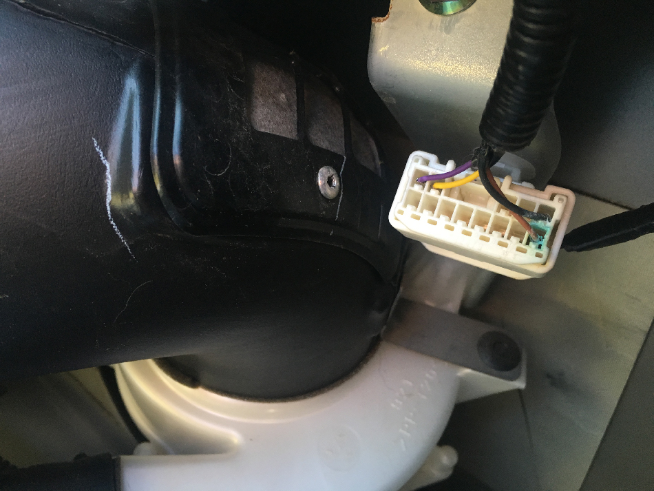

  13. SFO
    SFO Senior Member
    Feb 7, 2017
    5,302
    4,251
    Northern California
    Nice work. While you have everything apart, be sure to check for corrosion at the battery fan and associated connector. Also check for corrosion in the larger white colored connector just to the right of the battery fan or up and to the left of the newly installed 12v battery :
    Check all of the connectors on the left end (drivers side) of the HV battery, including the the harness and HV battery ECU (below) :
