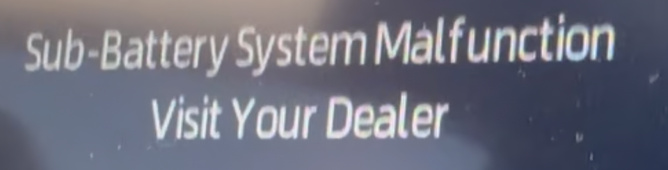

    My 'sub-battery system malfunction visit your dealer message similarly popped up and disappeared'. I keep my phone mounted on the dash so was able to record a video. You could keep your phone camera app open and ready so if happens again you can grab a photo.

    Paramount CA
    That sounds like a temporary voltage glitch in the 12-V system, with the DC–DC converter voltage dropping too much due to a high-current demand such as when using the electric power steering all the way to the stops etc. Usually, the system will raise the voltage to 14.3 V to prevent that from happening during high electric loads. You can ignore it unless it becomes a permanent message.

    I did ignore first happened in April. Both times it happened while using dynamic cruise control which abruptly turned off. First time soon after it happened I pulled over turned the car off and back on again and the message went away. When it happened another time in May the dealer ended up calling me right after it happened and set up an appointment. They replaced the INTEGRATION CONTROL SUPPLY under warranty.
