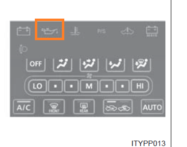

    The only time I know of that the red triangle comes on without a hybrid-system DTC being set is when it is telling you about low oil pressure. For that case, there should also be a small drippy-oil-can icon superimposed up near the top over whatever's showing on the MFD, but it might not be something that jumps out at you if you're not watching for it.
    Low oil pressure alerts are often seen briefly, like when you turn a corner and the little puddle of oil that's left in the engine sloshes away from the pump intake for a moment, but then sloshes back after you're around the corner, and the light goes out again.

    Well, I feel like an idiot. The engine was basically out of oil- nothing on the dipstick. Once I put in oil, no more red triangle! My son neglected to keep it topped up. This car apparently has carboned up rings and burns a lot of oil- I sure would like to resolve that!
    I still have the other brake related codes. I need to find my minivci cable or buy another, or buy a dedicated scanner and figure this out.
    I wonder if it is safe to drive it with those error lights on (minus the red triangle)? The brakes feel perfect.
