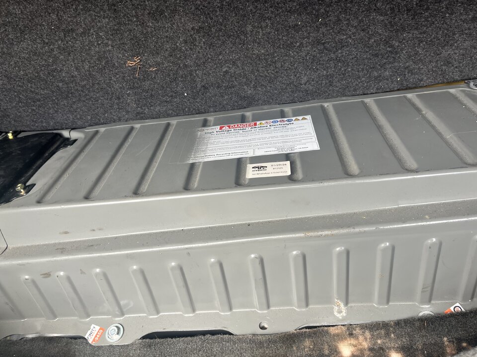

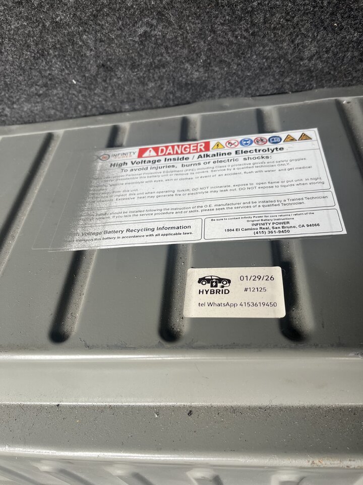

    2. the hybrid battery seems to be new/refurbished January of this year, but the service shop isn't on Google Maps or anywhere online. The battery service didn't appear on the carfax report. I tried calling the number on the battery's sticker (what's app only??) but it's the weekend and they didn't answer. Unsure about a warranty on it. See photos.

    That 12V battery would not appear to be sourced from what's app, The HV battery isn't from them, apparently, as their site does't mention hybrid batteries. Problems with either could/would trigger the red triangle.
    The O2 sensor might trigger the red triangle.
    Later edit: Infinity Power, whoever they are, seems to be the source for that HV battery. Don't know a thing about them as a hybrid battery supplier. The HV battery would be high on my suspect list for your problem.

    You could try to message Infinity Power about the HV battery through the WhatsApp app,, hopefully they'll get back to you.
