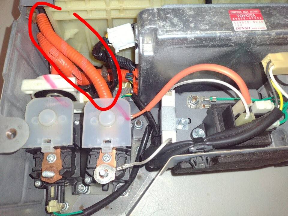

  11. mr_guy_mann
    mr_guy_mann Senior Member
    Sep 3, 2020
    4,118
    2,015
    NJ-USA
    Where is the HV battery cable that should go to this post on the relay? HVrelay.jpeg

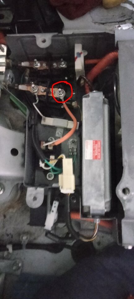

  12. mr_guy_mann
    Sep 3, 2020
    4,118
    2,015
    NJ-USA
  13. trsandy2000
    trsandy2000 Junior Member
    Nov 15, 2010
    29
    Hmmm. I don't know. I don't remember taking it off. When the temp cable came in I disconnected a cable from the left and the connector from the ECU. There was also a cable that came from the last module and had a flat strap that I hooked under the bolt that held the ECU down. I will go look at it. Could it possibly be the mechanic that "diagnosed" it was a bad hybrid battery took it? I would hate to think that he did. According to your picture that cable comes from left side of the battery pack. What is that cable that goes through the white thing, I don't know what it is called, and hooks to the left relay? I'm sure that when I took the old cables off I just threaded the replacement thru that hole and onto the relay. I'm on my way out to the garage now.
  14. trsandy2000
    Nov 15, 2010
    29
    Oh my gosh. I feel like a fool. I apologize for even thinking the mechanic didn't leave it in the car. I found a short orange piece of cable underneath other parts on my workbench. I remembered that it goes on the first module and to the relay. I put it on and the car started and although my dash lights are out right now, combo meter problem, I was able to put it into drive and reverse and was able to throttle up in neutral. Now I need to get the dash lights working so I can see the warning lights and get the codes erased. I am sooo close and I have you guys here on Priuschat to thank. If we were in front of each other I would be shaking each of your hands and buying you coffee. I will let you know what happens after I get it all done and seats back in. Thank you all a million times over.
