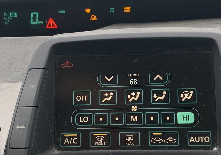

    The red triangle of death (shown below) has come on a couple times. Generic ODB2 reader gives no codes (other than P0446 and P0456 but it's been giving those for a long time, EVAP issues). Clearing the codes turns off the triangle. Some of the times the yellow brake warning came on the dashboard at the same time (not shown). Sometimes a black bar covers the main display with a red car icon and exclamation on the left (shown). It almost looks as if it's holding space for a message but it's blank. Possibly other squirrely symptoms I might associate with a computer browning out, just guessing.

    Yes, it is time to replace the 12v aux battery.
    My guess is that you have a problem with the hybrid battery. You need a better scan tool to retrieve all the trouble codes that have been triggered. Read post #1 and then scroll down to post #37 in this thread, https://priuschat.com/index.php?posts/3246758

    Your reader does not allow reading hybrid error codes.
    There are engine failures (check light on) and a failure in the hybrid system.
    You need to find a good pair: the correct OBDII adapter and a program that displays the correct error codes or the Techstream program and a cable for connection.
