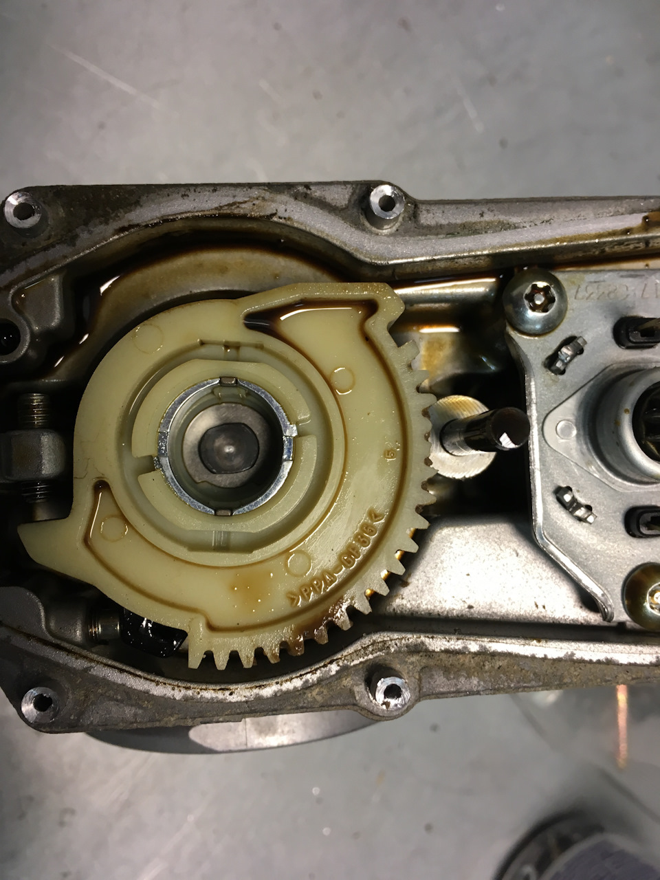

    The primary error P2111 may be a result of wear and internal damage to the gear on the throttle valve.
    You will have to disassemble and look at the insides.

    Thank @MAX2. So have to replace the throttle body? This plastic gear does not looks like a replaceable item. Thought of trying a used one, but with this plastic gear, its better to get the new OEM one.
    Never had to replace the Throttle body on a car :(
    I cleaned it yesterday and put it back. Drove few miles and so far no issue. But with this plastic gear inside, it will come back. Stupid design for a critical component.

    Third planet from the Sun
    It is probably wrong to say that all throttle valves have such damage, but its possibility cannot be ruled out. It is most likely connected with the jamming of a dirty valve when the valve drive motor tries to turn it. The plastic is fragile, some of the teeth are cut off.

    I was getting codes for throttle actuator stuck open. Tried cleaning it, but it came back and is random. When it happens, car won't accelerate and have to shut it down and start again to drive it. @MAX2 posted that picture about worn out gear inside. So i was trying to check the same on my old Throttle body. It seems the one in my car is metal wheel and the one @MAX2 posted had plastic. But, the other part(i posted 2 pic of it) is plastic on my car. So far other than the loose flap / loose connector(connector was not attached to body), i could not find anything wrong with it.
