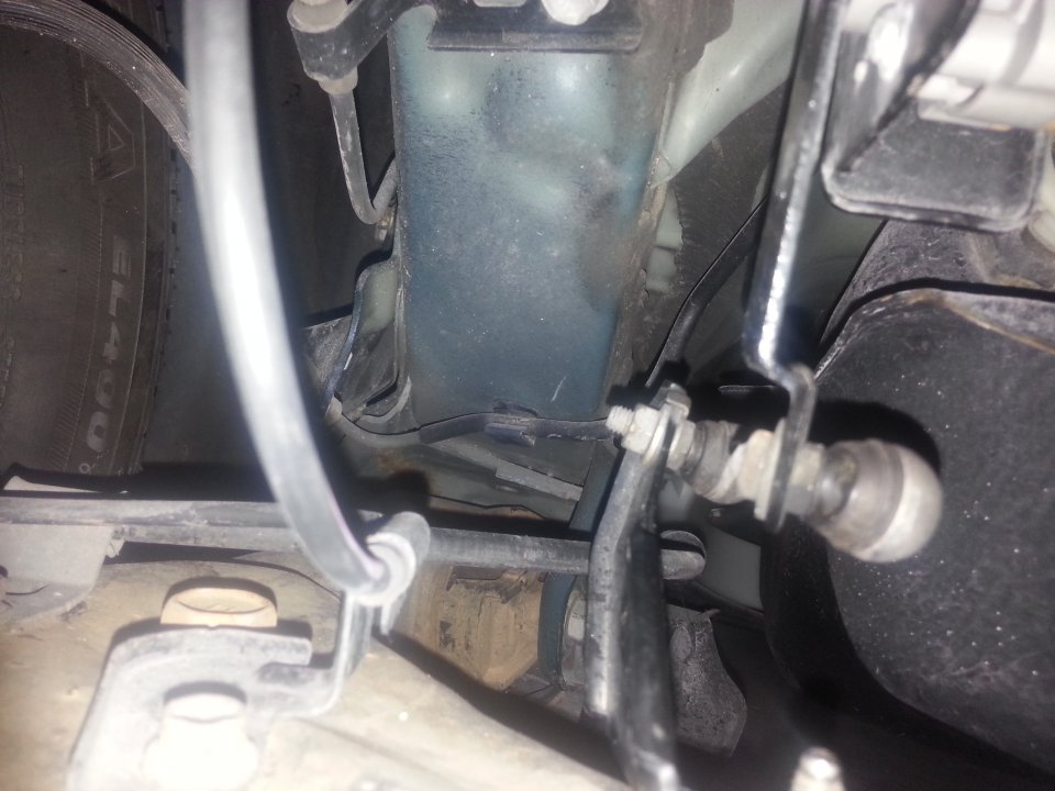

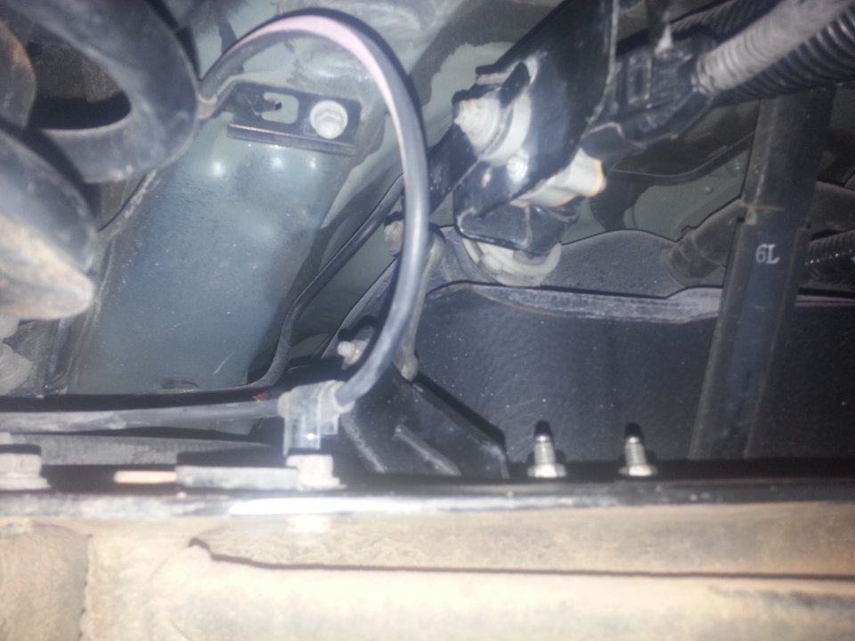

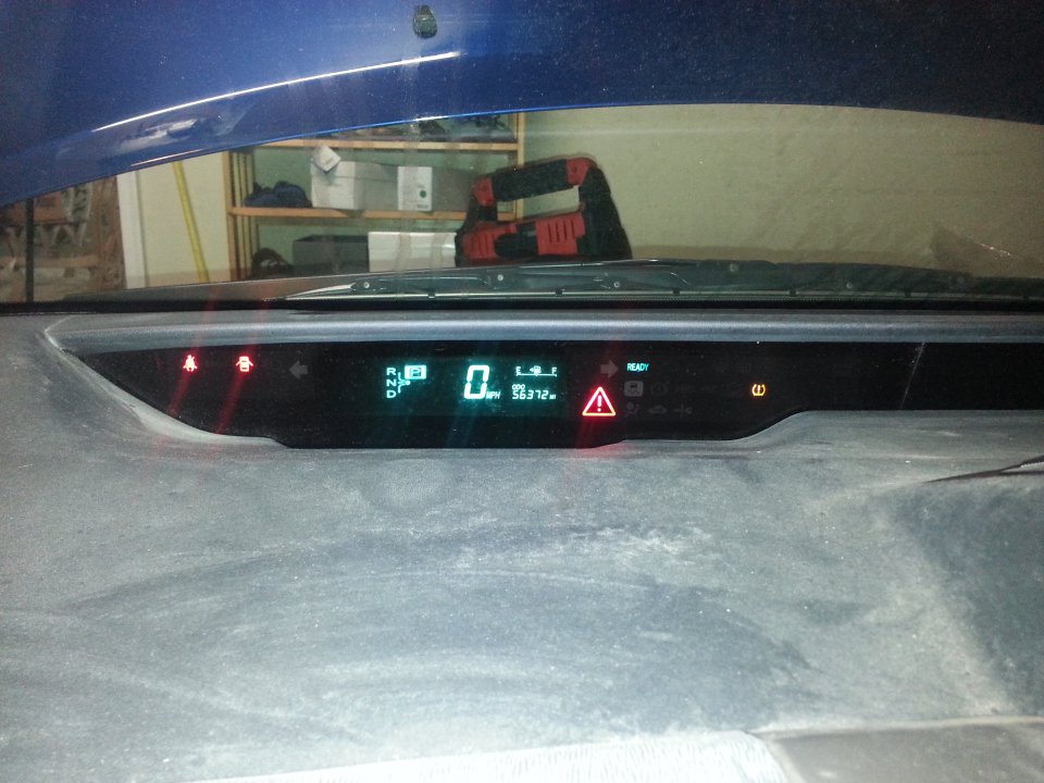

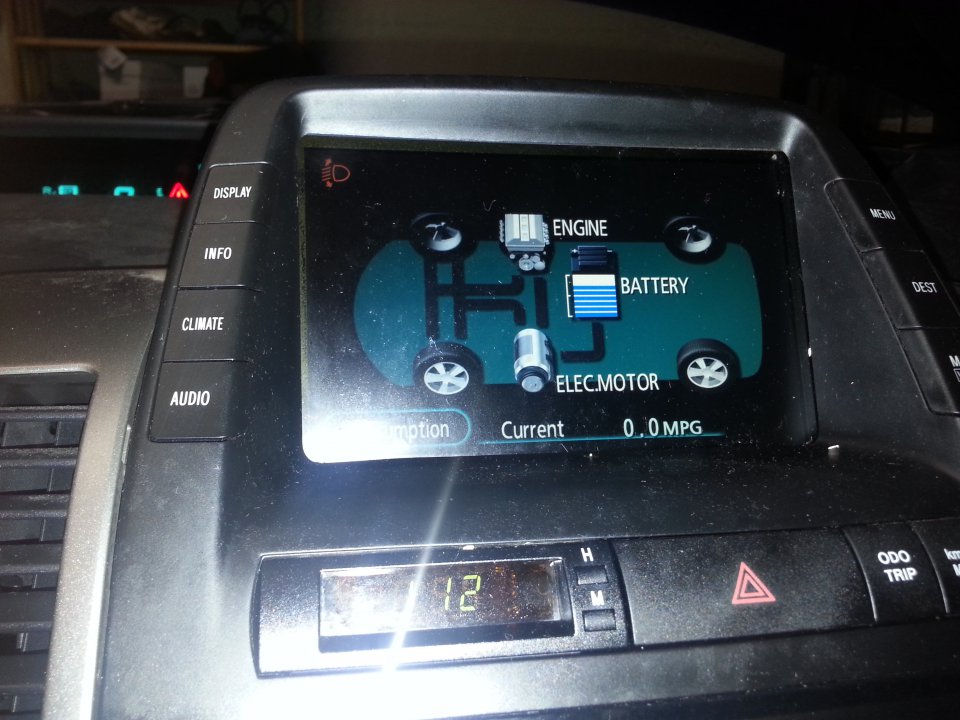

    I got red triangle and headlight icon on the screen. I hooked OBD and It gave me error code P1116, I checked all my front, back lights are working fine, please see the attached pictures I would be very thankful for any advice.

    welcome to priuschat! do you have headlight leveling system?

    I dont know, could you please let me know how to find out? I got fog lights with HID. Thanks

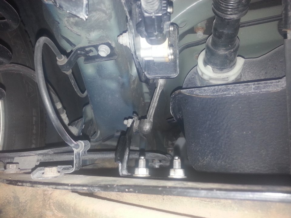

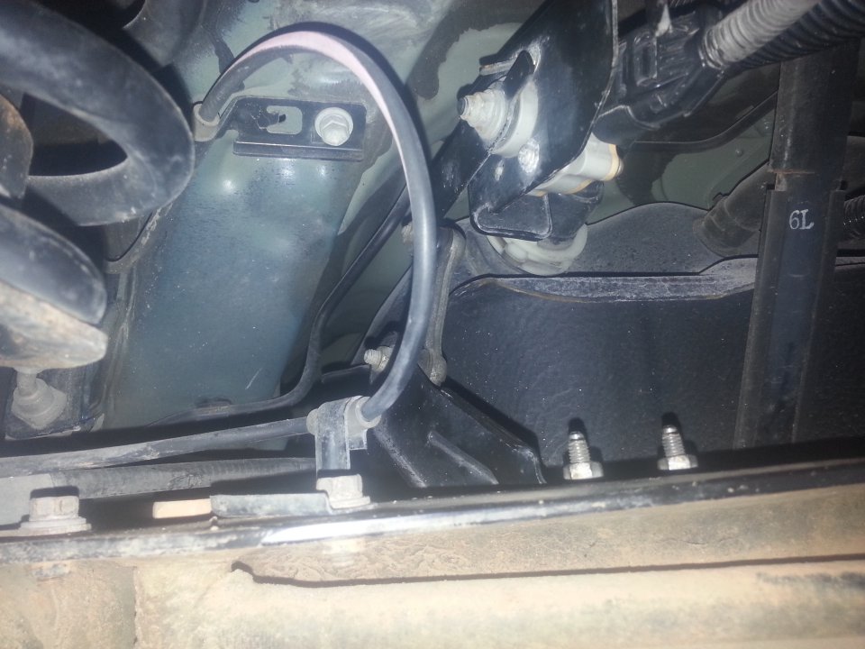

    I search around and I was able to find the sensor by the rear tire, I didn't take it out, because it looks good and connections looks good too. btw how this sensor works for the front HID lights? Thanks
  6. bisco
    115,454
    52,858
    when you put something heavy in the back, the lights point up and the sensor adjusts them back to level. in the early models, moisture was getting in and causing corrosion. i think jeff has your problem nailed in post #4 above.

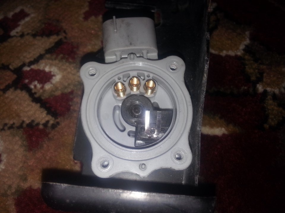

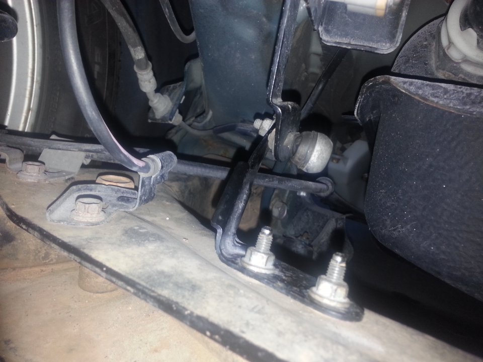

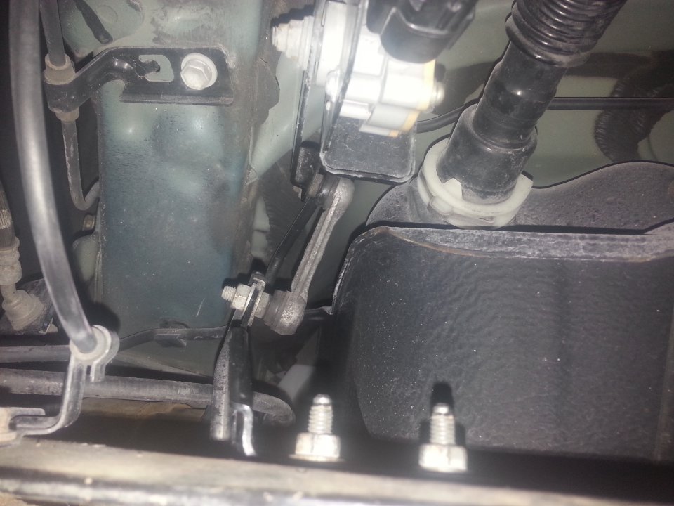

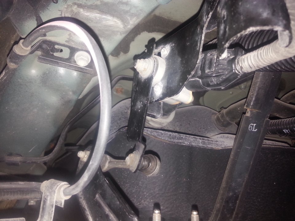

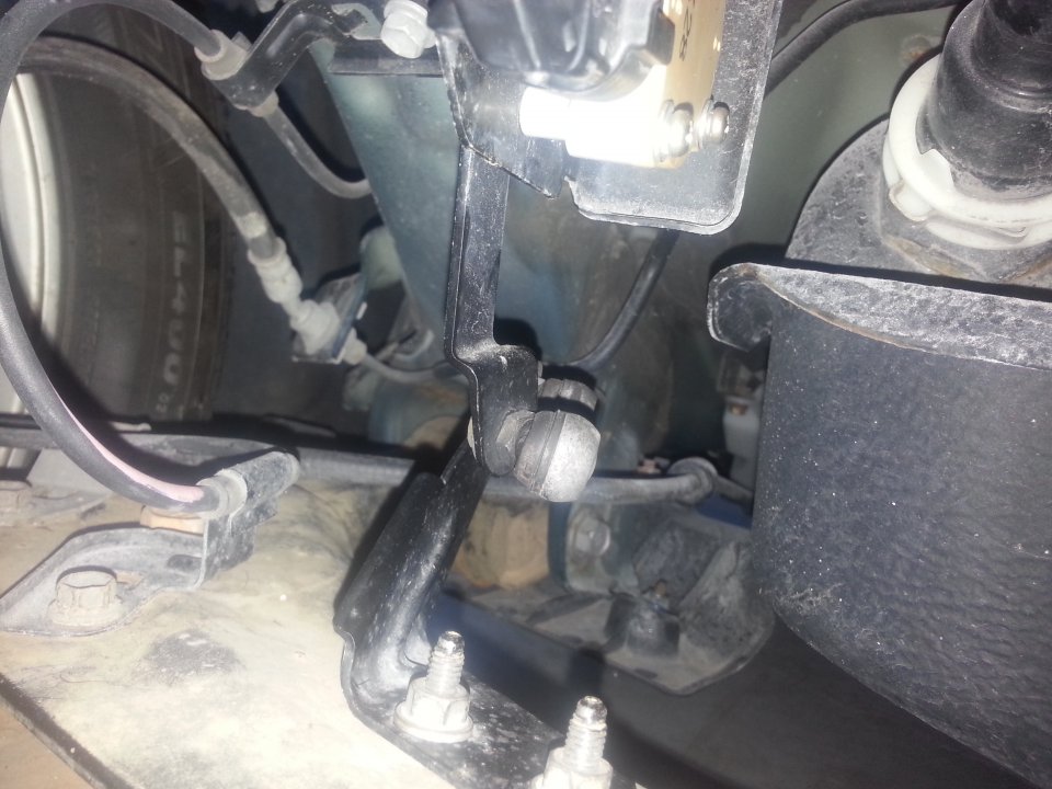

    Jeff I 'll check that. I took the sensor off and it looked in good condition, I took the picture of it. I put the sensor back and I still have that light on my screen. I don't know what else I should look into.?

    The headlight leveling sensor has three main trouble spots. The inside of the sensor, the connector, and the pivot arm. Any one of those three items can cause the leveling sensor to malfunction and light up the symbol on the MFD and the red triangle on the combination meter.
    Check the pivot arm for freedom of movement. Check the male and female sides of the connector to be sure they are free of corrosion. If all three items are good, then the problem may be at the ECU which would be bad.
  14. zfk110
    zfk110 Junior Member
    Feb 2, 2014
    97
    Atlanta, Georgia
    jadziasman, I looked for ECU, but I only found this
    04 05 06 PRIUS LAMPS LEVELING CONT COMPUTER 89960-47020 675313, I have 08 Prius. Do you think if I play around with pivot arm 'll help? Thanks
    jadziasman, Bisco, Jeff

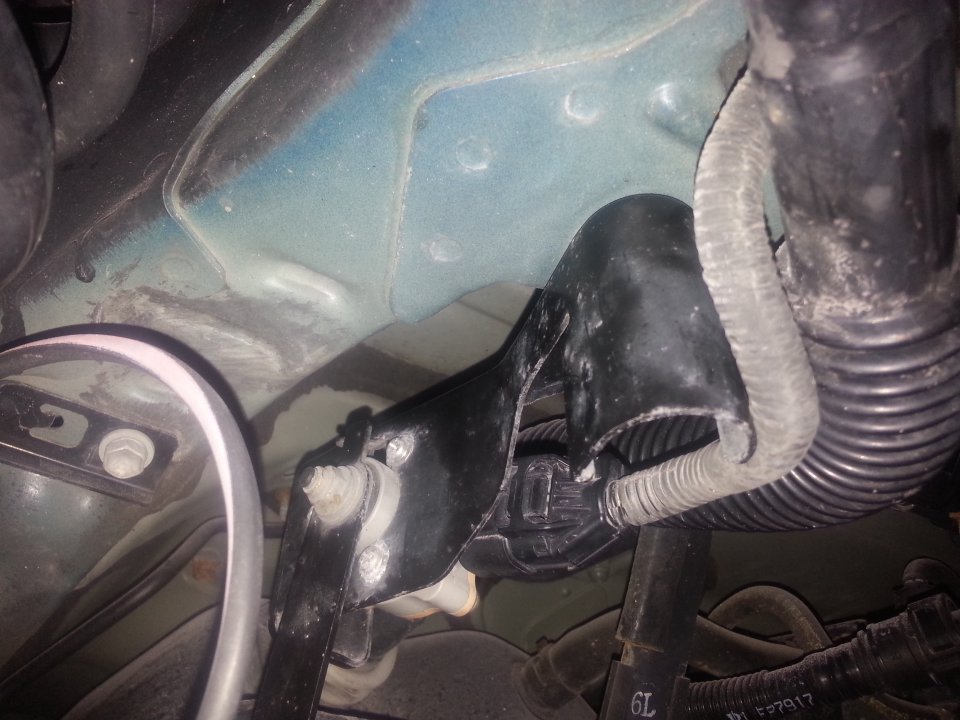

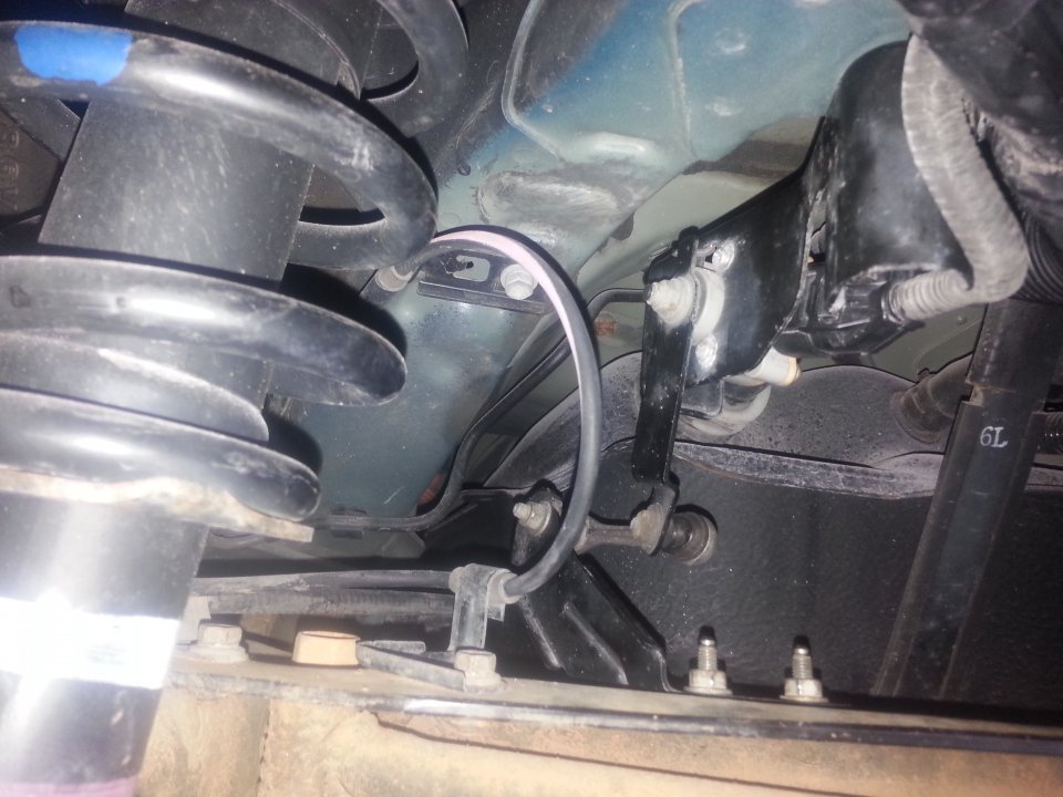

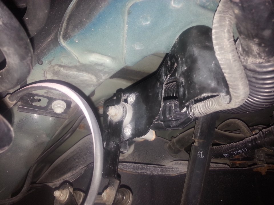

    Thanks a million. I got that red triangle and headlight icon on the screen fixed!!! :) I changed the location of pivot arm around and its all good. I got the pictures to show how its suppose to be. now I 'll see tomorrow about P1116, P1118 codes.. Thanks again for help! it wont be possible without it.
