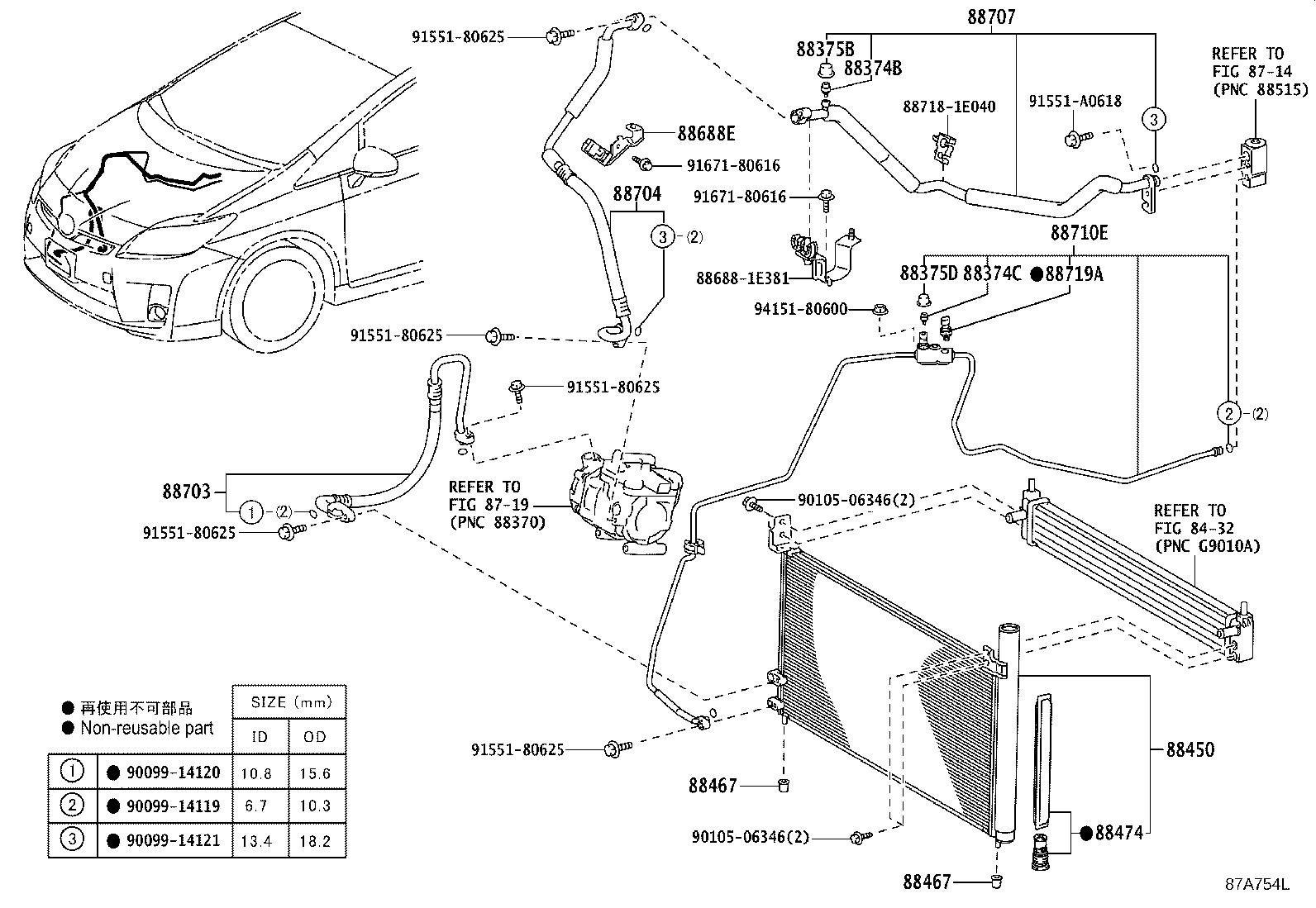

    Realize this topic has been discussed over and over again but there appears to be one specific difference in my case.
    The refrigerant line to my 2010 prius broke off from the compressor when it was hit by mistake while swapping the engine. The refrigerant leaked out completely and the screw holding the line in place on top of the compressor also broke off. A replacement screw was installed with the hose again at the top of the compressor.
    Is there a sealant required where the refrigerant line connects to the top of the compressor? When reinstalling the refrigerant should the compressor be vacuumed out first? Should a vacuum pump be used? Should the installation be with all new lubricant PAG 100? Could AC gauges be used without a vacuum pump?
  2. ChapmanF
    28,750
    19,055
    @lech auto air conditionin can give more specific advice. I can preview a few points:
    The only 'sealant' where the line attaches should be an O ring. The one on the suction line is a 13.4 mm ID, 18.2 mm OD, 90099-14121. The one on the discharge line is, umm, shown on this drawing but not labeled, oops. The drawing also doesn't clearly show that it's included with the line if you bought a new line, but I'm guessing it is.
    If there is any kind of mechanical damage on the compressor mating surface such that the O ring would not seal there, you're not likely going to find any 'sealant' that could improve matters. Just replace whatever broke and then put it together with the right O rings.
    Yes, the entire system must be evacuated before you add refrigerant, especially as it may have been open to the air for a while after the line broke. Also, you should replace the receiver dryer (88474 in that drawing).
    Yes, a good vacuum pump made for A/C work is the only way to draw a sufficient vacuum.
    You might need to add some new lubricant, but do not allow PAG oil anywhere near the car. Use Denso ND-Oil 11 or some other lubricant guaranteed safe for the electric compressor.
    If any PAG oil has been added already, all might not be lost. There was an article suggesting that if caught quickly enough, just replacing the compressor and HECAT H-1000 flushing all the rest of the system might save the day.

    I’m reading this on the fly while I’m driving between jobs so if I leave something out forgive me and if I get bad voice to text errors in poor word usage, forgive me I have no time to watch this while driving or edit.
    Remember, there is a seal on the other side of the expansion valve connected to the Evaporator that’s not shown in the diagram.

    Do you have a diagram of the seal at the expansion valve at evaporator you’re referring to? I see a diagram that appears to be behind the dash in the cabin behind the fire wall.
  13. lech auto air conditionin
    Sep 5, 2011
    830
    606
    261
    san francisco
    No, I do not have a diagram, but I know they are available and probably if you, Google search expansion valve O-rings for that particular year make model somebody should have posted something for sale online
