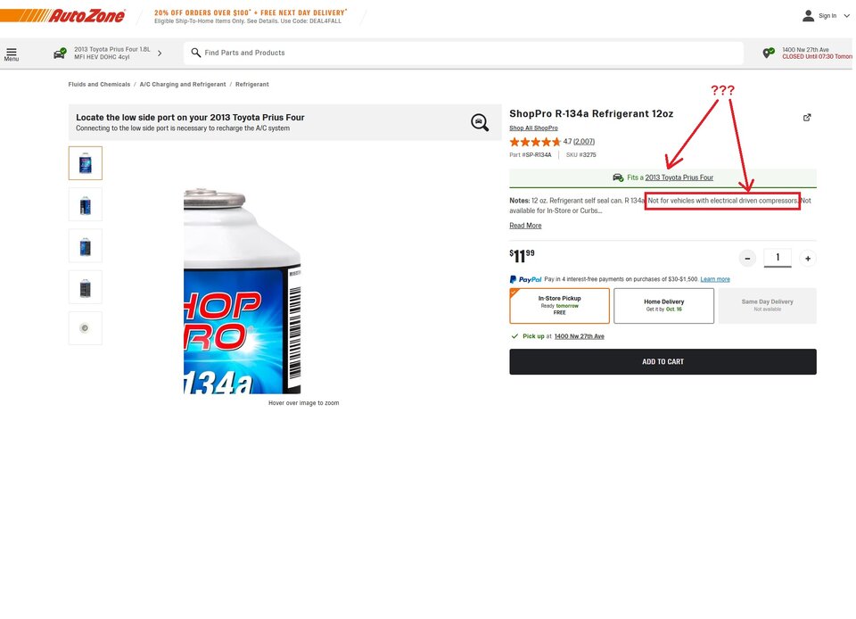

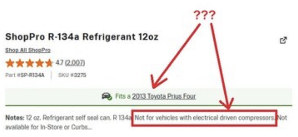

    Well, that is good news but I hope that R134A doesn't cause issues with the compressor later on. There must be a reason for that warning.

    Are you basing this warning on this website listing only? It is wrong.
    Gen3 uses R134A, so this seems misinformed by autozone galore. It’s the AC oil that’s relevant for these models gen2 and gen3, it needs to be ND-11 (expensive) or a POE 80 (POE 100 not preferred since different viscosity than ND11)….

    The best r134a for a gen3 top off is usually the cheapest can without any oil, dye or sealant.

    Always avoid any additives and add dye yourself if needed, it’s very cheap. Straight up R134a is the best but if you have replaced any components that can hold oil, add some Edgar Allan Poe80.
    @rjparker it seems you are not commenting on why autoZ would not recommend this can for electrical compressors? Please enlighten me.

    Additives beyond pure R134a has to be the answer. All recent hydrids and most cars since ~2017 don't use R134a.
    With that said, trusting anything Autozone, their code scanners or employees say is foolish. But in this case the customer could be foolish if they ignore the warning.

    I'm well aware of the need to use ND-11 oil with the Gen 2 and 3 models and not the normal PAG oil that is used in many belt driven compressors.
    My concern is that if the supplier clearly states that this product is "Not for Hybrid vehicles with electrical driven compressors", why would anyone in their right mind even consider using it for one of these vehicles.
    Unfortunately, Autozone's website only shows one view of the can so it is not possible to check online to see if it contains any oil or other additive. Apart from that, a 12-oz can of straight R134a is cheaper at Walmart so, better to play safe instead of taking chances.

    But it’s much more likely they have a DB error that states this. It’s R134A that is recommended for the gen2 and 3, so we don’t want to confuse folks looking for answers here with invalid AutoZone info. Nothing indicates this can has additives. It only indicates they have a bug.
