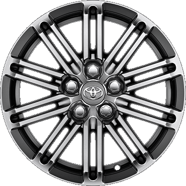

    I just got decent price on 4 Dunlop Winter Response 2 tiers, 15" rims and TPMS sensors. By end of next week they should be on and I will know for sure about the two sets of TPMS sensors on Prius 4.
    PS I really love the rims. PT945-47160 hyper black double spoke alloys rims.
