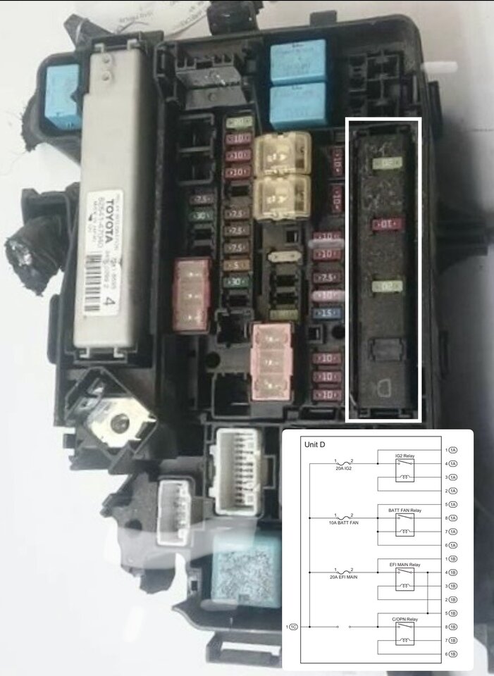

    On a gen3 it is either the white module or the smaller black module in the engine fuse box.
    Each has two tabs on each end to allow it to lift up. There are cables with connectors on the bottom that usually have enough slack to disconnect but the cables will be stiff.

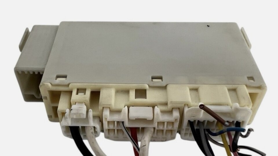

    White Integration Relay from a 2011 Prius at a local hybrid shop. A 2010 will have a different part number
    Bottom view of above from ebay part

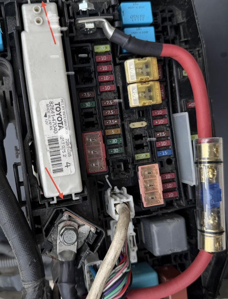

    Smaller Black Integration Relay

    They are real pain in the butt to change too very carefully..get car inside wer can be hot . Take a heat gun set on 225 and go around the box bottom area get wires very warm . The unit will pull up almost 2 inches . As you pull it up give the plugs a shot of heat they slide off mo better. I hate these things
