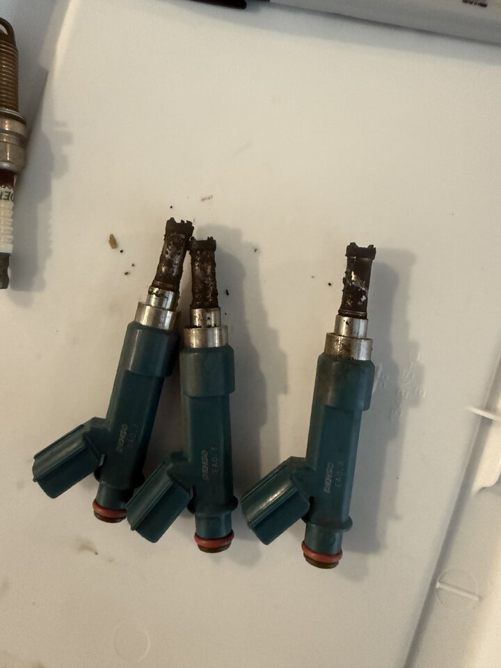

    These were what my injectors looked like at 85,000 miles.
    indel likes this.

    Gawd danged at 500K mine don't look anything like that just silver and green lil bit o shiet on tip. Wen I blast thru w cleaner not much happened . Not much dirt etc. oh welp.
    12mpg likes this.
