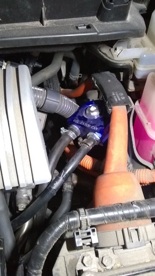

    While I had the intake manifold, EGR pipe/valve/cooler, and PCV valve cleaned last summer for my 2010 Prius at 242K km, I also added an OCC (Oil Catch Can).
    8 months & 8,000 km later .... While changing oil & servicing brakes today, I noticed the OCC and decided to open it to check. Actually I hesitated for a while because I thought there might not be much stuff inside. How wrong was I!

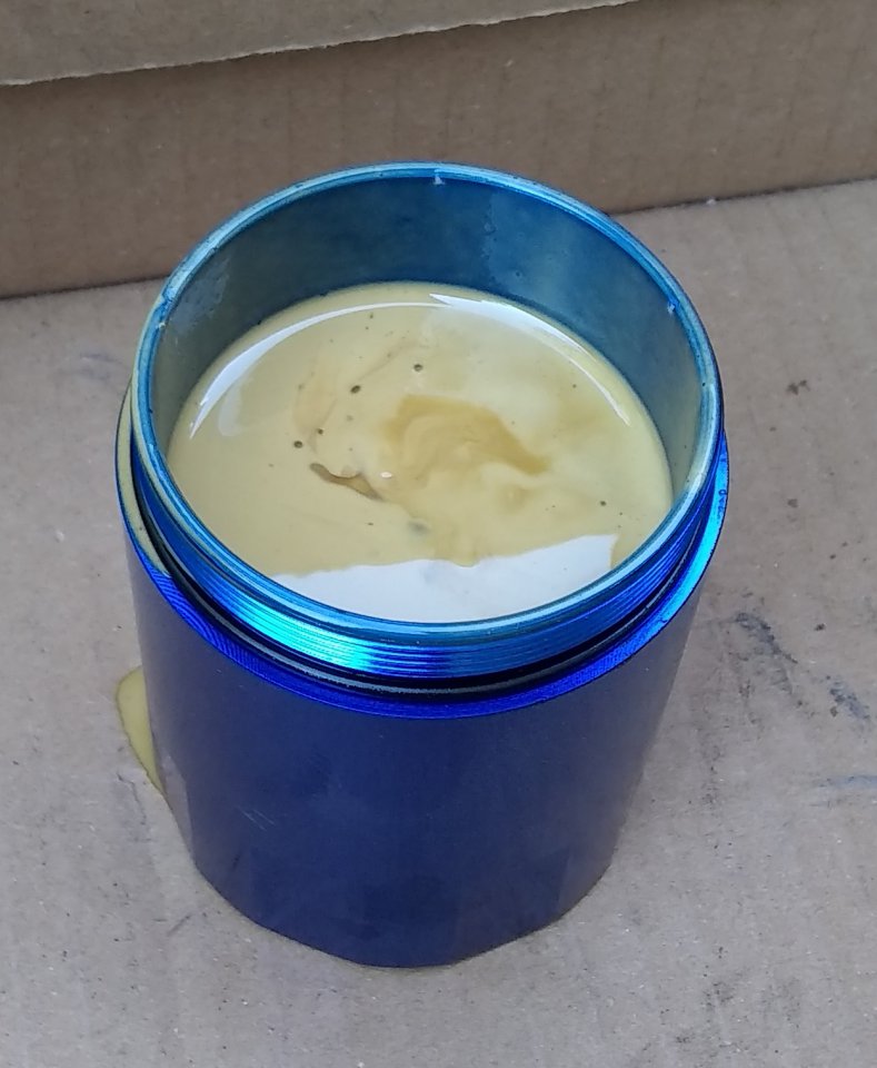

    The OCC is totally full, with yellow/brown foams on top, oil under, and some kind of more dense yellow/brown stuff at the bottom. Got my hands soaked as I didn't expect a full can. Washed so many times and they still smell oil as of now.
    Will check at least every 3K km from now on.

    The bottom layer is mostly water, with water soluble stuff of some sort colouring it.

    I didn't put any filtering material inside the OCC. The outgoing chamber of OCC has a metal bottom with small holes on it. Guess that design offers some "filtering" effect.
    If you put any filtering material inside the OCC, you'll have to change it every time. I don't think it's practical to clean any material soaked in that oily fluid.
