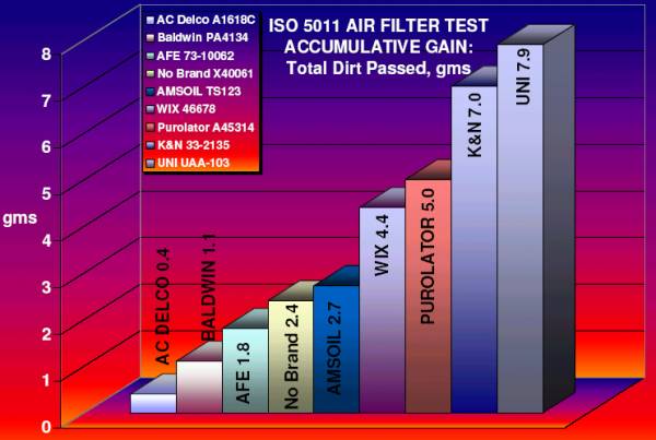

    Filter Efficiency (How well does the filter captures debris.)
    Accumulative Gain (Total amount of dirt that passed through the filter.)
    These two graphs speak volumes. If you logically think about K&N's premise: increase Horse Power by increasing air flow. The less restrictive the air filter, the greater the air flow. Unfortunately, more debris will be passing through the air filter (as shown above), into the intake manifold, then into the cylinders. Even if no cars are ever damaged running K&N air filters, is the cost of the filter, filter oil, filter cleaner, and required maintenance of these filters require, worth K&N's claim of 1-4 Horse Power increase?
