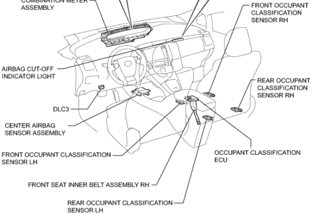

  9. ChapmanF
    28,612
    18,947
    Might you be thinking of the "belt-warning occupant detection sensor"? That's in the cushion, and is a simple yes/no sensor for the seat belt warning, and doesn't have any calibration.
    I was talking about the "occupant classification system", which has the more challenging job of determining what size and type of human, or non-human, is occupying the seat, for use in adjusting the airbag inflation force. The "occupant classification system" uses the four strain-gauge sensors located as shown:
    Note: both images above are from a gen 3 manual. It may be possible that Toyota radically changed how the OCS works in gen 5. I'm open to being shown wrong by someone posting the corresponding details from the gen 5 repair manual.
    That's the advice that's hard to beat. ;)
    (Again, from gen 3 manual; any changes found in the gen 5 manual would be welcome.)
