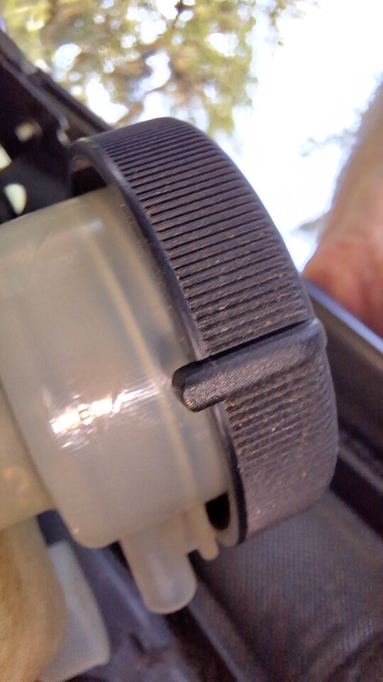

    Old post, but hope to help somebody. My dangling tit/tab/knob on the bottom rim of my cap has been turned beyond the detent in the reservoir ?overflow port? (black rubber capped port) and feels too brittle to pass back to its normal travel circumference. I'm going to clip the tab a bit at a time and see if the cap will stay in place or if I need to buy a new cap. It seems the best course of action in this Florida heated 16 year old reservoir. I'm lucky I haven't cracked the reservoir with the battle so far. I don't know who the culprit was, but when I find them!!!
    Seriously don't think it was me, but seriously could've been. Mine: upload_2026-6-12_14-18-4.jpeg
