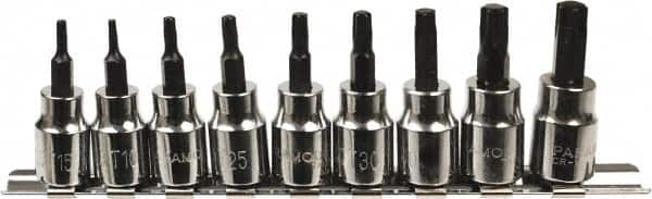

    First thing I'd try would be a Torx bit socket that's just a little too big to fit in the hole.
    Pound it in with a hammer and use a ratchet or breaker bar to remove the plug. That will probably work, but if it doesn't, then I'd use a Dremel to cut a slot across plug head and use a cold chisel at an angle to make it move counter-clockwise rotation.

    Belts and braces: hammer something in, like a torx bit, or a hex socket, then tack weld weld it in two or 3 places, before applying torque.
    Just guessing: maybe 3/8" (9.525 mm) allen key was used initially, in place of of 10 mm? Stanley for one makes a nice set of metric allen key "sockets".
