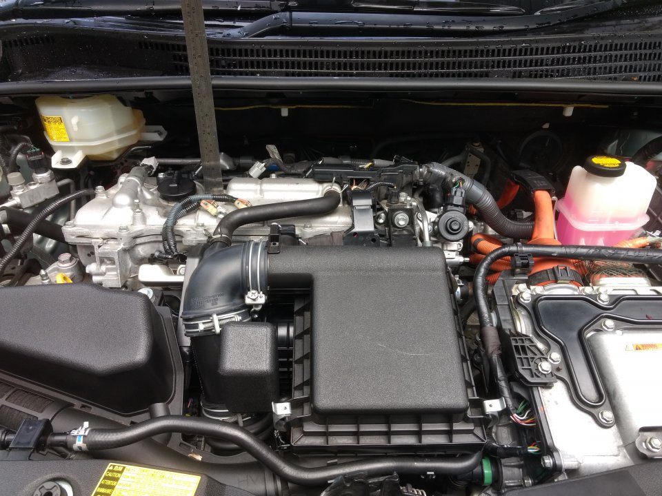

    I have a 2012 Gen 3 right hand drive (face lift model) imported for Japan. I have never had to remove the wiper cowling to remove the spark plug and was wondering if that was because I have a right hand drive or the face lift model.
    For reference I have also removed the EGR cooler and replaced the Air/Fuel sensor (although that was a little tricky) without removing the cowling.
    Any feedback from international members....

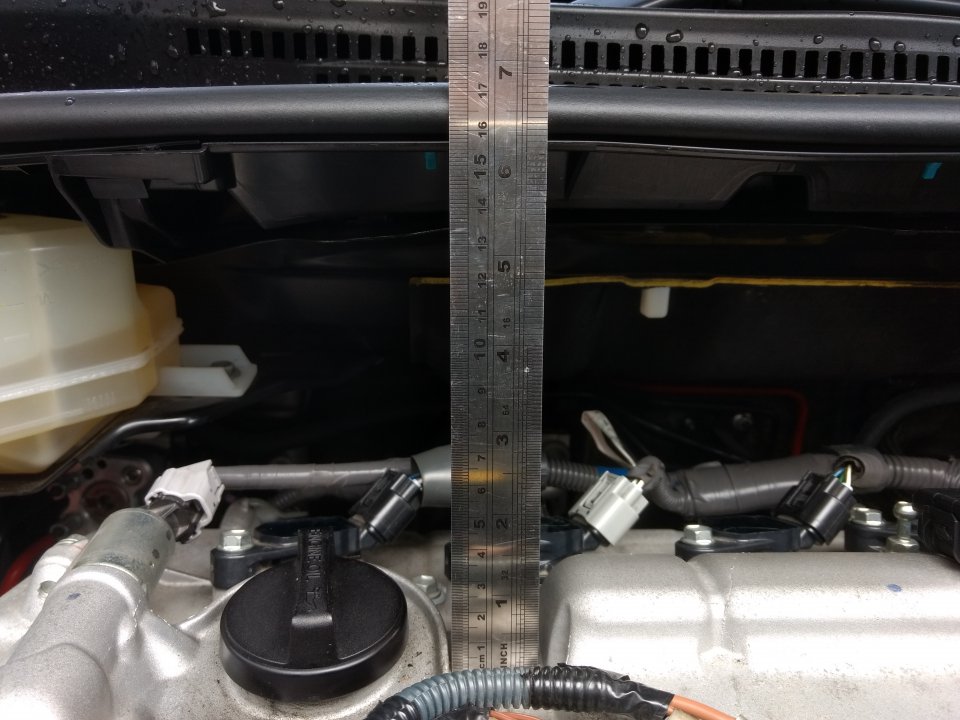

    I do have to use two 75mm extensions together and disconnect them as I am bringing the spark plug up. The limiting factor is whether you can get the ignition coil out, if there is no clearance for that then that's the end of the discussion.
    Wipers the way they were originally designed.

    I measure 3-1/2", roughly. The grill work above looks a lot different, less area is grill on mine. Or maybe that's a 2012 onward thing?
    The underside of the cowl is some sort of fibrous material, for sound-deadening I suppose. But it doesn't give at all.
    Maybe some significant differences in the cowl:
