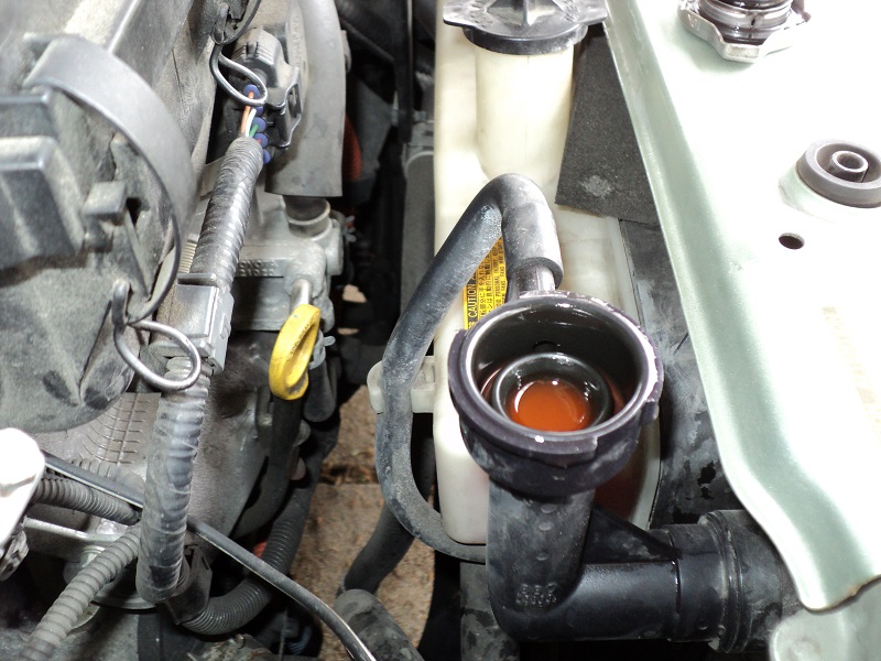

    I had a Gen II Prius. Been down the road you are on.
    Go ahead and fix it. You can change the belt yourself and the ICE water pump at the same time. Patrick Wong posted some detailed information on how to do the repair. Search with Google and you should find it here on Prius Chat.
    The coolant flow control valve is a common repair on the Gen II Prius. Had to change ours also. Seems like a lot of the Gen II's suffer the same thing, that stupid valve. It will cause the CEL to light up and also set a DTC or MIL code. A decent Prius aware scanner can read all of the codes. The best scanner out there for DIY is the "mini vci". Google search and purchase this on Amazon. Avoid Ebay, as some of them seem to be infected with malware.
    The coolant flow control valve can be changed also DIY. It is a little more labor intensive. I believe again that Patrick Wong posted the repair online here on Prius Chat. When you change the valve along with the ICE water pump you must replenish the coolant. It is recommended to use the Toyota SLLC (Super Long Life Coolant). It is imperative that you also bleed out ALL of the air pockets within the system. Again this procedure has been posted by Patrick Wong. A Google search will reveal it. A "air lift" tool or the "Lyle Funnel" are helpful when bleeding the ICE coolant loop. Don't get confused by thinking you only need to look at the overflow bottle on the Gen II to check the coolant level on your Prius. At times the bottle will be full, but the radiator will be low. You must remove the splash guard over the radiator, then remove the cap. The fluid should be level with the top of the neck just below the cap. Observe the picture below for a example of what a full radiator will look like on your Gen II Prius.
