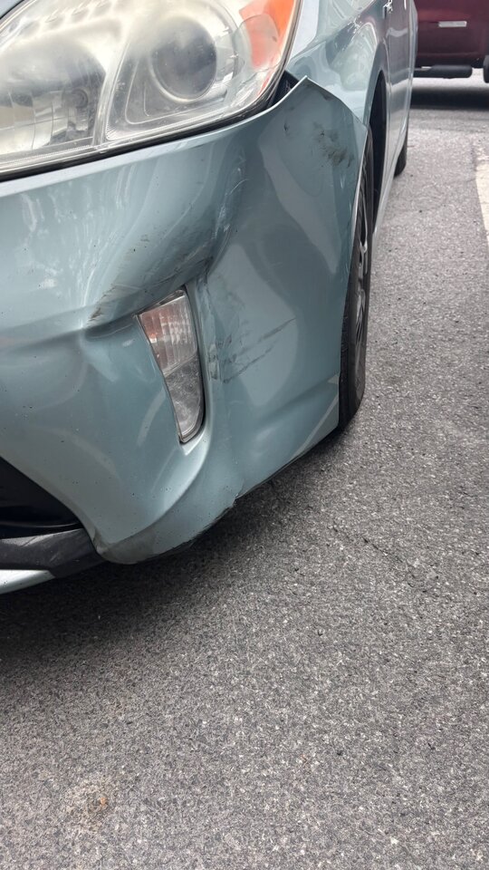

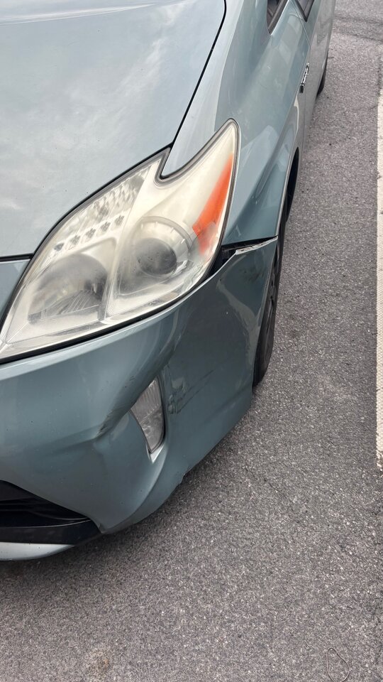

    My 2013 Prius was in a fender bender, see attached photos for the damage. I've tried the technique of pouring boiling water over the outside while pushing from the inside, to no success. What would you try next? This seems a bit complex for a suction cup, although perhaps that would help? Thanks!

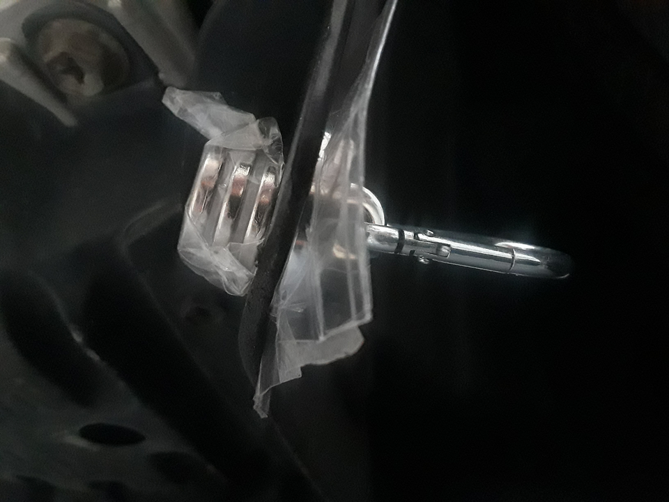

    I've been using magnets a lot lately to pull minor dents.
    Home Depot sells these magnets. But try them at your own risk since they are pretty powerful and can cause scratches or damages if not handled right. They have 45lb, 65lb and 90lb rated strength. Best to pull on warm or hot weather. Covering them in a strong pouch can help to prevent scratches and easier to pull back out.

    This is my little set. Even this set is pretty powerful.

    I've done lots of these... I use a heat gun on the inside if possible or very carefully use a heat gun on the outside if there's not enough time to pull bumper cover. With the cover off a soft sole shoe you're wearing pushes it out pretty good, but if bumper cover is on a crow bar, pry bar or long screwdriver can push it out but the ends of the tools can damage the plastic super easily so softening them with plastic or duct tape is wise.

    Go out and heat it up gently with the heat gun keep it moving don't melt the paint it'll probably plop out on its own or push from behind the fenders farther back this is a polymer

    What am I missing?
    The photo shows the rubber bumper cover collapsed/ dented.
    Magnets I don't think will aid in the repair as the damaged inner components are keeping the rubber collapsed.
    OP, what to do next?
    Remove the bumper.
    There is more than likely metal support structures that are bent and holding the cover in the collapsed position.
    There may also be broken parts, plastic brackets, and other components that only replacement will work.
    If it has been that way for some time, the bumper may retain its deformed shape.
    You could try a heat gun to bring some shape back.
    So... remove the bumper.

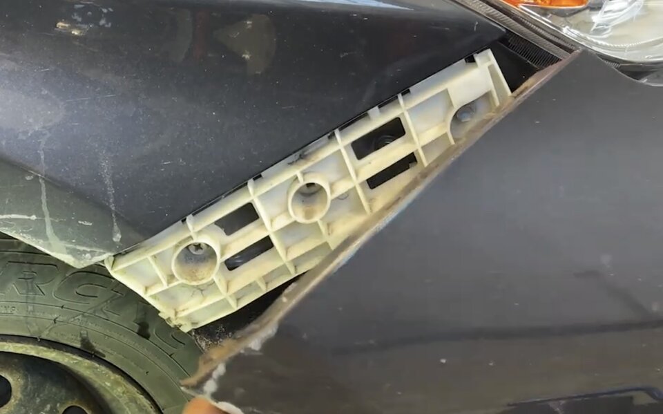

    The easiest thing to do is to partially or completely remove the plastic bumper cover.
    I would partially remove the side with the dent by removing the top screws and clips and one wheel well screw and clip. Then one or more bottom screws on that side as needed.
    Then push out the dent from the inside.
    The bumper cover is flexible; in fact there are sellers who prepaint aftermarket covers and fold it for shipping.
    I have done a partial removal to replace a headlight assembly once and replace a bumper mounted light assembly another time.
    Auto supplies have clips if you need one. As long as you have the screws it will go back on.
    Video of complete removal for visual learners

    Every clip that could break is easily replaceable after the bumper cover is on because the screws hold it adequately in place.
    The critical joint at the fender and the bumper cover pulls out by hand and snaps in place nicely.
    From above video
