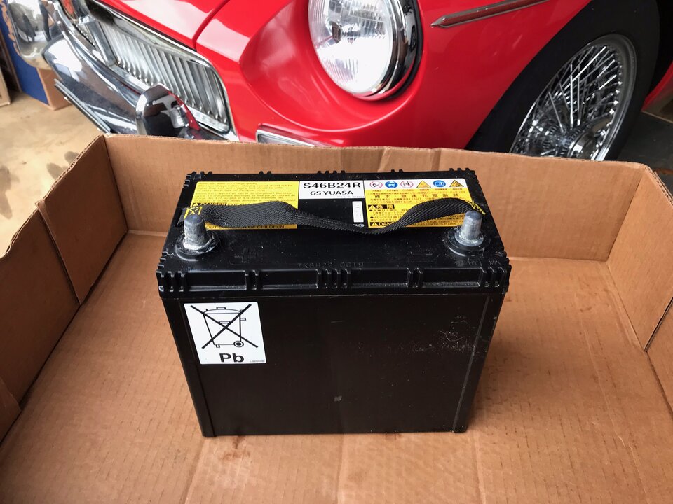

    I have a 2007 and this is probably the 2nd time my cars 12 volt battery got drained. Is there a way I can replace my battery with a much bigger capacity even if I have to change the post clamps and as long as it will fit my battery compartment.
    Here are the specs.
    S46B24R
    GSYUASA
    9 Width x 8 Height x 5 Depth

    Refer to the "mobility battery" thread.
    Fitting mobility 12volt AGM battery. | PriusChat
    Some of the batteries mentioned there are 55 Ah, if I remember correctly. However, they require some work to shoehorn the slightly larger batteries into that space.
    Probably easier to wire a permanent charging line to the front jump point and make a point of charging the battery overnight every week or two. Straight to the battery is possible too, but running the wires out would be more difficult. That should take care of it if the battery is going too low because it isn't driven a lot. On the other hand, it won't help at all if the car is left for many hours "off" with a significant load on the battery.
