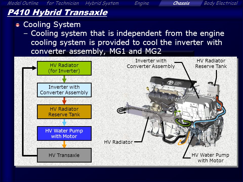

    1) There is no cooler for the ATF, the inverter coolant loop does run antifreeze through the Transaxle. There is a tiny pump to circulate ATF WS inside the transaxle while the engine is running.
    There is no need to 'flush' a simple drain and fill every 60,000 miles will do.

    That is the clearest photo of the engine/transmission I have seen to date, thanks!

    you show a 2012 Gen 3 Prius, so your transaxle looks nothing like that Gen 2.
    Here is an overview of it's cooling system:

    Actually the op has a good point. There would be metal debris in the inverter coolant loop. Not a lot as there is a small in.ine filter in the trans but I would be concerned also.
    Easy to fix.
    Disconnect the 12 volt battery in the trunk.
    Dump the inverter fluid.
    Pull the trans.
    Put the 2 trans coolant hoses in 2 separate small buckets because one hose is pumping the other is sucking.
    Fill both buckets up with distilled water till you can determine which one sucks and which dumps.
    Once buckets installed and filled then fill up the reservoir.
    Remove power connector to inverter pump. With ohmeter determine which pin on that pump plug is chassis ground Then you know the other pin is hot.
    Jump in 12 volts to the hot piñon that pump,
    Now your pumping flesh distilled water. Should have fluid dumping into one
    Small bucket and sucking out of The other.
    The water will be sPitting as you pump but that’s ok.
    Keep an eye on the dump bucket till you see clear distilled water.
    Set up that dump side bucket so it just overflows on the ground and keep the reservoir And the suck side bucket full.
    Before installing the new trans pull the dump plug on it and see how much metal is on the magnet end of the plug. Try to get dome of the fluid out in
    Pan and put the pan in the sun and see if you see any non ferrous metal floating in it. Would really suck to reinstall a bad trans,
    After trans installed dump inverter plug again and fill it with TOYOTA SLLC COOLANT AND BLEED INVERTER.
