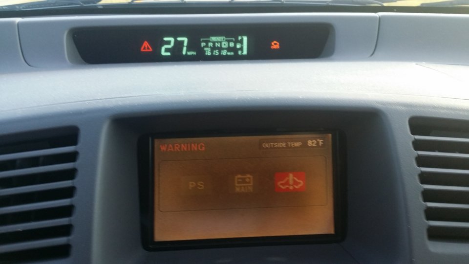

    Update:
    Took the car to Advanced Auto Parts to check the "check engine" light, just to get a second perspective besides Autozone, and just to make 100% sure. The verdict was confirmed, and got the P3006 error code. So the guy reset it for me, and code went away again.Drove for a good 15-20 minutes in the city, and the day and tv screen lit up like crazy again. Anyway, I went ahead and ordered the wire with CD, and will wait a few days until I receive it. So thanks to everyone on here for the input. It has been really helpful. Once I receive the items, I will look for guidance here again! I guess I will need some "hand holding" to see what the next steps here on out. Any veteran/moderator on here that knows of local recommended hybrid techs near my area? I attached a picture of my dash.
