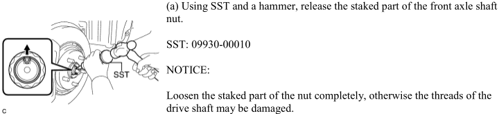

    Not hard but I would get new axle nuts. The factory nuts are staked and if you can’t get them un staked you can just take them off with a impact gun and replace them. Mine came right off but you may need to rent a something to pull the wheel bearing off the cv axle if you live in a rust area.

  6. tak1313
    tak1313 Member
    Apr 7, 2016
    38
    MA
    It's extremely easy - UNLESS the hub unit is corroded to the knuckle. If it is, how easy it is will vary by how bad the corrosion is. It can vary from a few taps to pop it off to 10lb slide hammer, to using a GOOD air hammer to start it rotating at the base on axis to break the corrosion.
  7. ChapmanF
    28,735
    19,033
    :eek: If you do it that way, replacing the axle is also a good idea.
    If the spindle threads take damage, bets are off as to how well the next nut will hold after reassembly.
    Some repair techniques can create known risks and still cause "no problem" much of the time, leading people to report having used the techniques with "no problem." But when a warning about the technique makes it into the manual, generally it has caused somebody a problem.

    Yep. You stand a decent chance of galling up the end of the axle shaft if you just blast the nut off with impact.
    I took a tapered punch that's as wide as the angled lock slot on the axle. Then I ground the tip at 45° or so (grinder or dremel). The flat bit of the punch rests on the flat lock slot. As I hit the punch, the the rounded part of the tip drives the staked section of the nut out.
