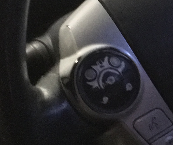

  14. MagnusAG99
    MagnusAG99 Senior Member
    Feb 21, 2017
    673
    521
    Norway
    This is how the controls look like on my Prius, aint no washing to clean that off for me lol. Excited to get the new black controls, i noticed the black ones i bought do not have the voice assistant button on the steering wheel, but that thing is useless anyways...
    Just to those that are confused about what i mean with my buttons being horizontal and the ones on the facelift being vertical.
    This is a 2009-2011 model.
    This is a 2012-2015 model (the way they shouldve been from the start IMO)
  15. ttou68
    ttou68 Active Member
    Sep 9, 2017
    351
    211
    40509
    Yeah, it does indeed needed to be replaced..
    You didn't mention the rubber has been partially worn off.. lol..
    MagnusAG99 likes this.
