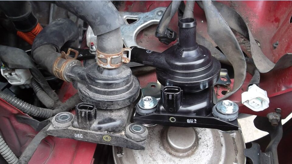

    have had the check engine light for the diverter valve for about 6 months and just now got around to doing it. Figured since I was in there, would do the inverter coolant pump as have no idea if it was ever replaced before I bought the car.
    So, I used the burping method with the radiator hose, and then did the trick of jump the relay with my volt meter to run the pump. Initially got 1.5 amps as it was mostly pushing air. But as I went I got it to where it was consistently using 4 amps when I would jump across to run the coolant storage tank (or whatever it's called)

    You are aware that the inverter cooling system is separate from the ICE cooling system, correct? Running the inverter pump will not bleed air from the ICE cooling system, which is the one with the 3 way valve you replaced.
    I would think that you would want to do this but let the car stay in Ready mode for several hours to bleed the air out of the ICE cooling system. Also, be sure the heater is turned on.

    Yes I'm aware of the different coolant systems...bleeding the inverter system was insanely easy.
