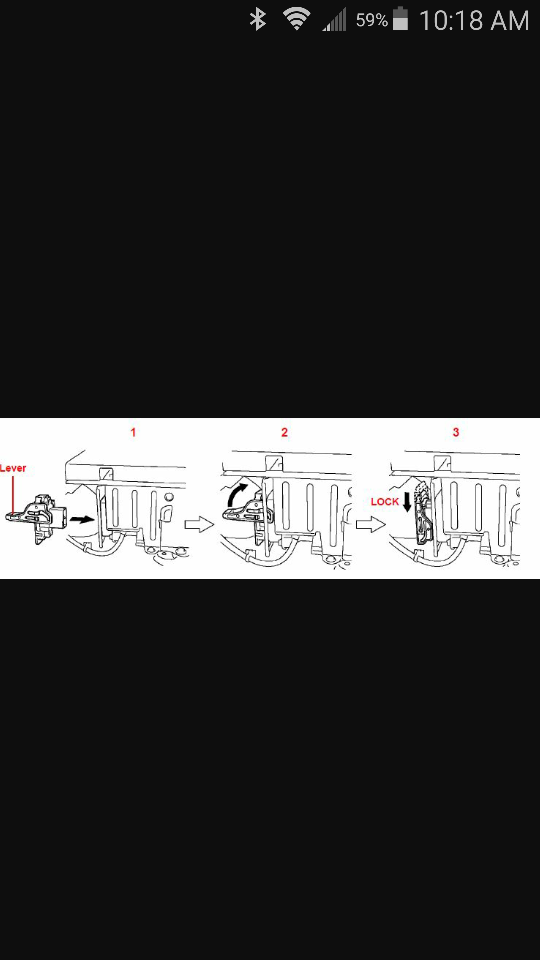

    Try to reconnect the orange interlock switch on the hv battery. You need to lock it in place by pushing it down to lock.
    Flip the switch lever up and then push downward to lock
    Press the start button a couple times to start

    I've seen mention of how the interlock switch locks in a downward motion, mine locks in an upward motion. could be that last year I replaced the HV battery and maybe it was slightly different.
    will double check the interlock on the inverter, could have swarn that it clicked when I put the cover back on, but will check again.
    thanks

    You first flip UP and then slide the switch DOWN to lock.

    not really confusing, OP just didn't read post 2 carefully.
