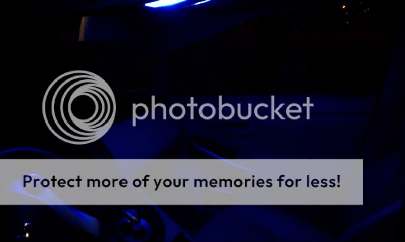

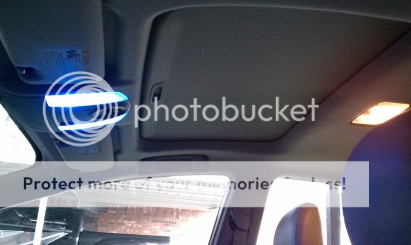

    I got my 9 LED bulbs today and tried them in the license plate spots.. but those also are too long to fit.. you can't even get the bulb back into position with the LED plugged in.
    Not sure if the 5 LED would work but maybe.
    Humm... since I can't put the 9LED in the parking light spot or the license plate I decided to use them as my front dome lights... since they are blue it definitely add a cool effect.
    I will have to use them awhile to see if they are irritating or pleasant.
    Nightime shot
    Daytime shot
