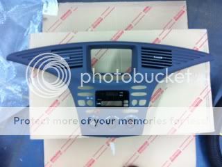

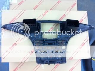

    If you remove the Gen1 center dash panel for any reason it will most likely break...it seems the plastic has gotten brittle with age and it can crumble when removed. I've noticed this starting to happen a lot in the last year or so.
    FYI; new replacements can be ordered from the dealer.
    Part number 55405-47030-B0
    Not cheap...dealer List Price is $203.25 online sellers will be cheaper...
