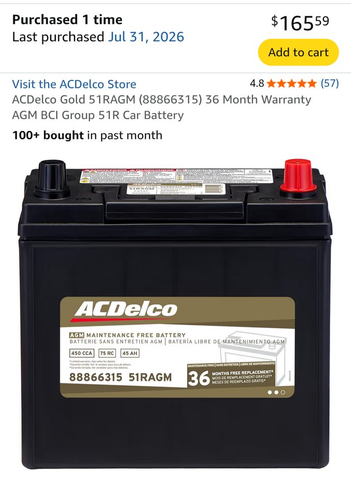

  13. War_Destroyer
    War_Destroyer Junior Member
    Oct 11, 2021
    42
    Los Angeles
    2002 Prius
    ----USA----
    I bought this ACDelco Gold battery, its AGM, and no need to pick it up in-store when its 109F out on a Sunday or deal with the whole "core deposit" transaction lol
    I am confused about the SAE to JIS terminal post adapters though. The old Panasonic battery says JIS and the ACDelco says SAE but the terminal posts on both batteries are the same size?
    It's too hot out right now to check fitment in the car, but it seems that I won't need the terminal post adapters?
  14. Trombone
    Trombone Active Member
    Oct 26, 2019
    389
    130
    Allentown, Pennsylvania
    2002 Prius
    Use the adapter for the positive clamp on the Prius, and purchase a ground cable that fits the Delco, replacing the OE ground cable.

  15. War_Destroyer
    Oct 11, 2021
    42
    Los Angeles
    2002 Prius
    ----USA----
    What I was trying to say was that I didn't need the adapters at all, the clamps on the car fit the Delco battery just fine, and for whatever reason the posts on the Panasonic JIS battery were SAE? Unless I'm missing something? I also could not find the vent port on the chassis unless it's that little hole in front of the battery by the ground cable and need a longer tube. The battery sits a little slanted and was hitting the sharp edge of the chassis by the positive terminal, but I put some steel reinforced rubber liner that I had lying around.
  16. Trombone
    Oct 26, 2019
    389
    130
    2002 Prius
    OK!, I need to improve my reading comprehension skills. The Delco battery already has the matching terminals, contrary to expectations, so you are in business! Congratulations! Now, do you still need to address an HV battery issue, or does the new 12V resolve that too?
    P.S. You might consider re-using the original battery hold-down bracket. I think it will fit, perhaps with a little finagling. BTW, you’ve got the ground cable screwed into one of the holes intended for the battery shield that installs on the trunk side of the battery. The threaded hole for the ground cable is down in the wheel well near the negative end of the battery.
    P.P.S. That empty hole beside the battery is for the hold-down bracket screw. IIRC, the vent hole is on the wheel well side, down low. It has a rubber grommet around it with a center hole for the vent tube. Frankly, I don’t bother with venting, as I consider the risk of hydrogen off gassing to be minimal. But if you hear about an exploding ‘02 Prius in Pennsylvania, that was me!
