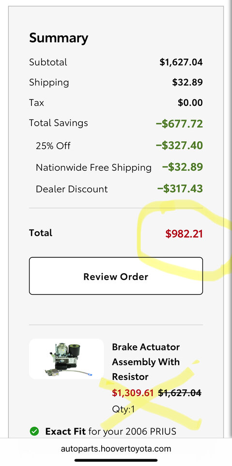

    Actuator Assembly, Brake - Toyota (44500-47141). This part number replaces 44500-47140.
    The new (online) price for this part from Olathe Toyota is currently $1,209.83, which is discounted from the MSRP $1,627.04 (25.6% discount of $417.21)
    I'm not sure what's up with the website. It says this part is OEM Toyota Actuator Assembly, Brake For 2006-2009 Toyota Prius, but then over on the right, it says this part does not fit your vehicle. It is definitely the correct part number for a 2006 Prius.

    Hoover has good prices

    These are available online new from Toyota dealers for $1200ish. If I planned to keep the car, I would spend the money on a new one. You don't want to pay labor twice or more if a used one doesn't work correctly. Doing the job right takes a bit of time as there's also specific brake bleeding procedures and some minor programming to do. Anyone can do it half-assed and skip steps because "i don't think it's needed". Two days later you have a bunch of chirping from the brake system because all the air wasn't removed. There's only one right way to do it.

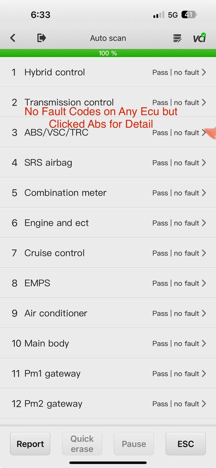

    Ok, so I got the reader and plugged it into the car. I have all the software downloaded. It says that it pairs with my phone, and the green light turned to solid blue. I was finally able to run the autoscan. It scanned through a long list of things, ticking up the percentage the whole time, and it got to 100%. Then, I got this error message about abnormal VCI function. I've done this three times and keep getting it. I also got the error message about communication status. I attach screenshots of both here. There's a green check mark by the VCI, and a steady blue light on the device. Thoughts?

    If it's looking for Ignition-On, that is 2 presses of the power button with your foot NOT on the brake pedal.
    There are some ecu's (out of the typical 16 in the car) that don't always communicate properly when the car is in READY state.

    Aha! Ok, it wanted two presses, and I made a little bit of progress. But now it says there are no error codes! This was when I used the autoscan option. See attached. Now should I try it in Ready state?

    If you power cycled the 12v, codes may have reset.
    I borrowed an AP200 from a guy and tried it on my Prius v. I also read no codes but it has no symptoms. No problem using it in Ready.
    You want to be sure you are asking for all ecus, in my case it was 20.
